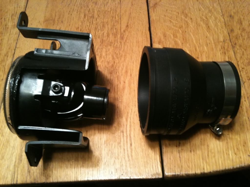

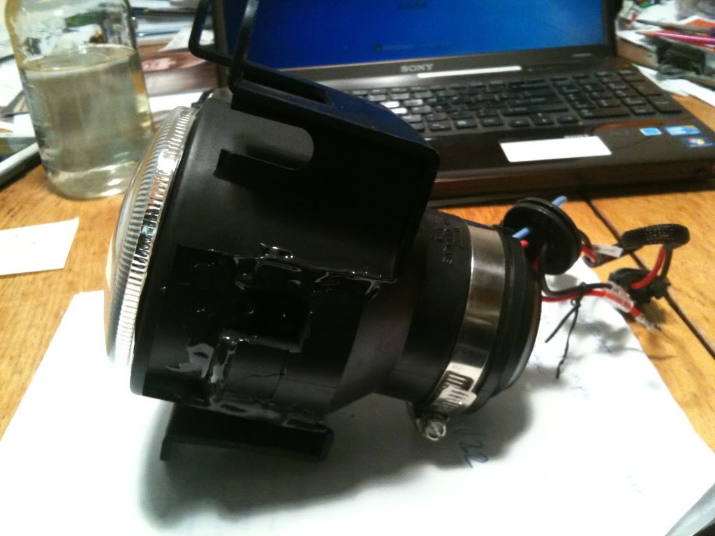

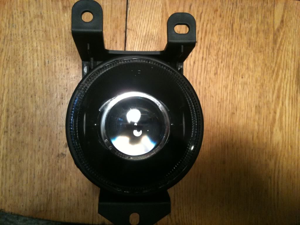

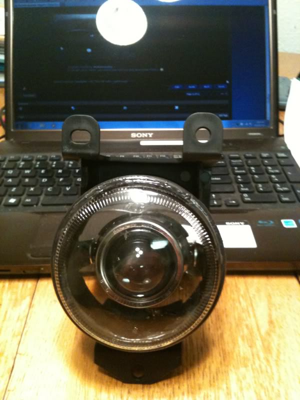

Success....finally. And I still have the other one to do, but hey. Progress is progress. I got the lens off, which gave me access to the shields. Was able to quickly sand off the black paint to metal, so now I'm ready to paint. Here's a few pics of this little assembly:
Inside looking out, with top shield cut out (turn your computer monitor upside down for the correct perspective on this one....lol):
The whole thing taken apart. I have sanded the black paint off the front of the lower shield in preparation for painting:
Now I just have the other one to do. These are more tedious than I was expecting, but hopefully the second one will be easier now that I've had time to play around with the first one. I've totally jacked up the cutoff shield with nicks and whatnot, so I may JB Weld a small, flat piece of flashing to the inside of the shield to give it a perfectly flat edge again.
