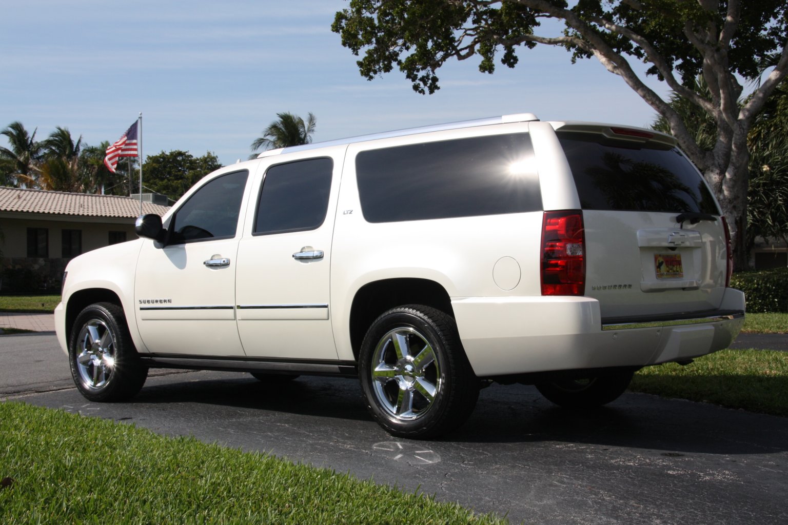

My daughter said today was going to be a great day. She was right.

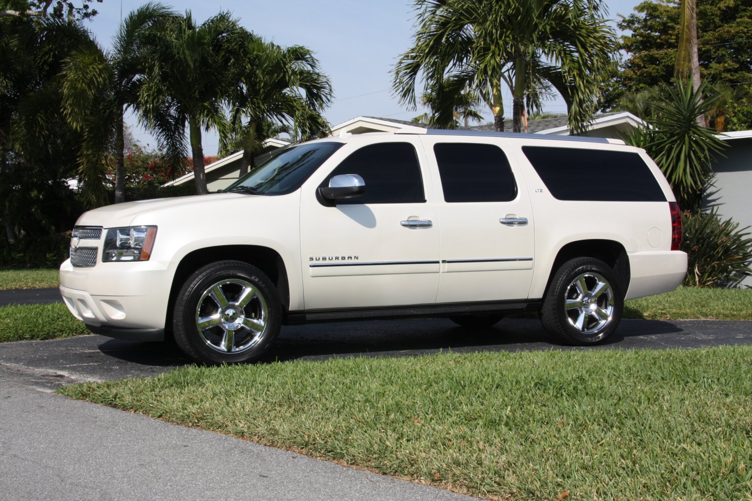

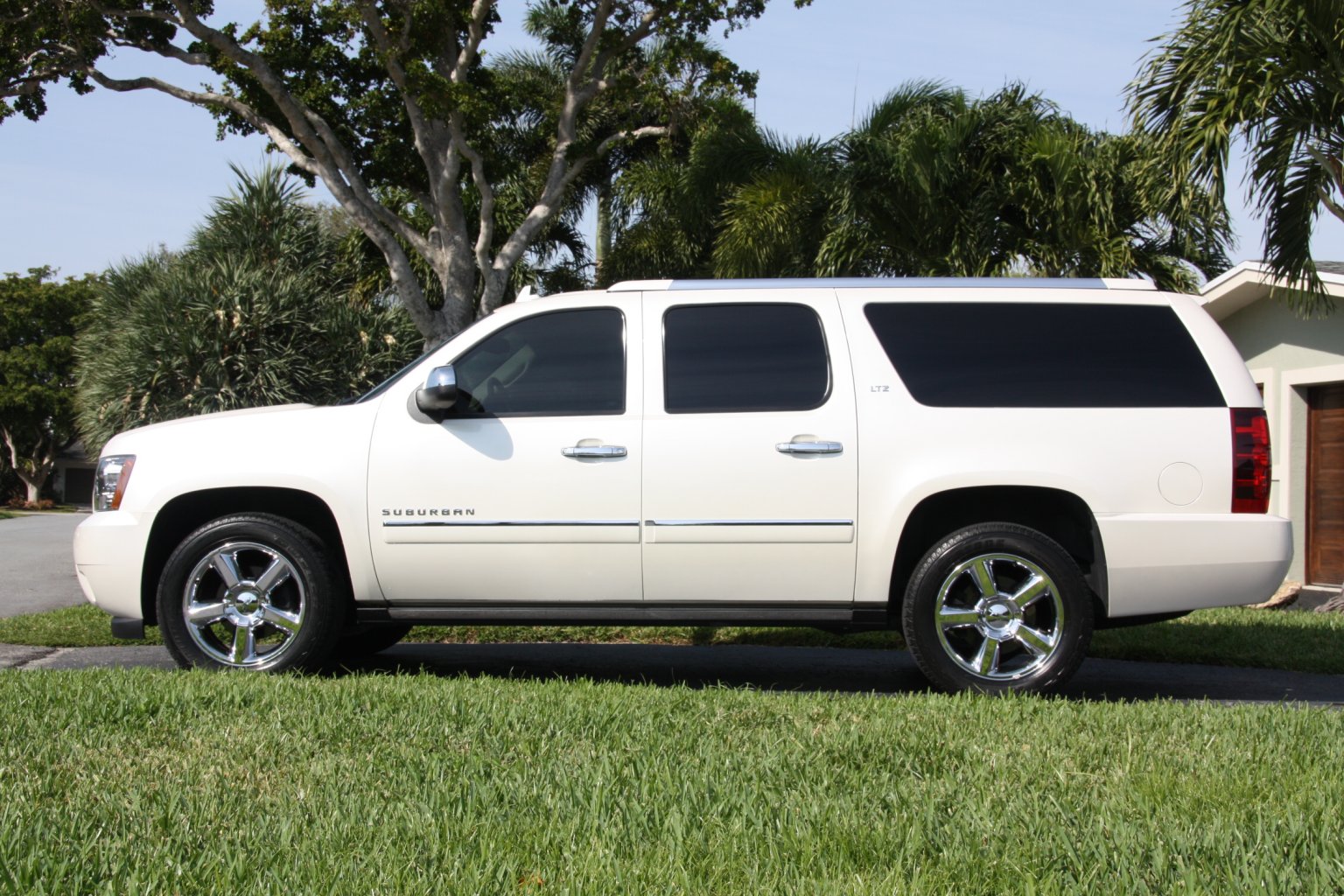

The Escalade roof rack is installed and looking sweet.
Let me start out with a funny story about my search before my actual write up.
I started the search for the Esky rack back in late October when I knew I would be buying the truck. I found one on eBay and bought it. I waited a little longer than what should be expected for the shipper to get back to me with shipping info wondering where my paid for rack was.
The following messages from the vendor responding to my emails are unedited from our comms back and forth about the rack. :doh2:
1st message
"Hi on your Most Recent Purchase as we were getting ready to ship your item a Day after transaction was Completed i have some sad new my guys put the roof rack near our Heavy duty Part something fell on the roof rack Damage the item as we looking in our warehouse to Locate the other Unit that was Inventory way before this unit me guys cannot Locate it at this moment we were looking to issue a full refund we apologies for any inconvenience or Delay this may have Caused we are so sorry about this Matter thank you for your time and Patience."
2nd message
"Hi we are Not happy Because we Would Definitely Like a Customer who need to item to get it in Great Shape instead of Damage in Our Warehouse. But am Definitely Working Hard to Make Sure you Receive A Replacement from another Vehicle we brought off the Auction. if you Have Seen Another Roof Rack Else Where Please Lets us Know So we can Issue a Full Refund so get it thanks."
Final message
"Hi Good day we got the truck off the Auction did a Inspection Chrome section was Painted by the First Owner in some Green Army Color the cap as we are not in the OEM Pearl White Please be advised that we will be just issuing a Full Refund to your Account Sorry about any inconvenience this may have Caused thank you for your Cooperation and Patience."
My refund was issued and I went back on the hunt. I could only find two ESV/XL roof racks with WDT end caps as I was hoping to not have to color match those. One sold and the other one looked a bit rough and then a third one popped up. I bid a few dollars off the asking price and it arrived in probably the best packaging for a used part I have seen. Long box stapled together, filled with foam peanuts with every part plastic wrapped individually and taped together. This rack is from an 2003 Escalade.
The whole rack was pretty dirty, so I separated all the parts and gave it a good scrub. The WDT OEM painted end caps are in perfect condition and only needed a light compound and wax to get them protected and super shiny. All mounting hardware was included and in great shape. The cross rails are off the truck at the moment and just need a clean, paint and clear to get them back to that OEM look.
There are no scratches on the chrome rails and they shine, however if you TYF look at them you can see they have had a long life in the sun. She looks good, compliments that long body and I'm pretty stoked to have that Esky rack on the Suburban.

Nice rack!! Lol. Looks amazing, 110% better with that one.

Thx man. It is a nice rack indeed!! lol Definitely makes the difference and finding the end caps in perfect condition was a score as well. Plus I wanted to match the 06 on top. :rolleyes:
