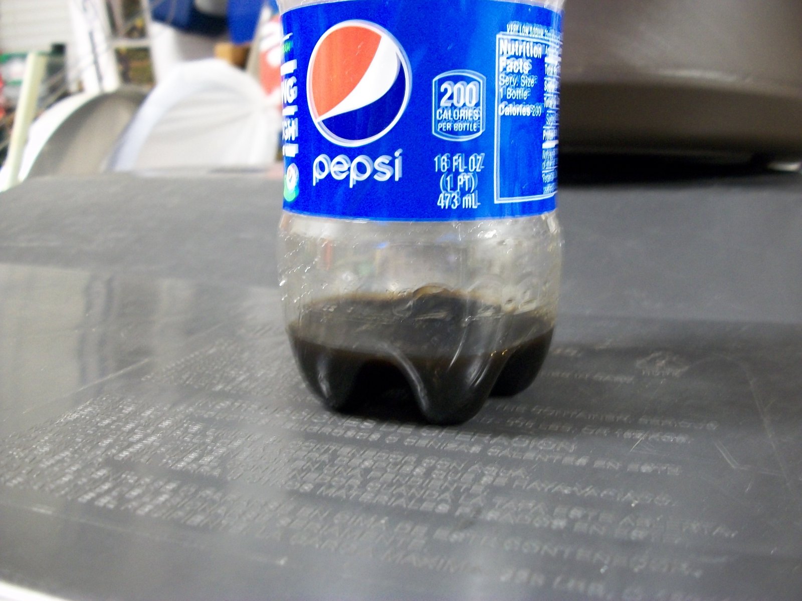

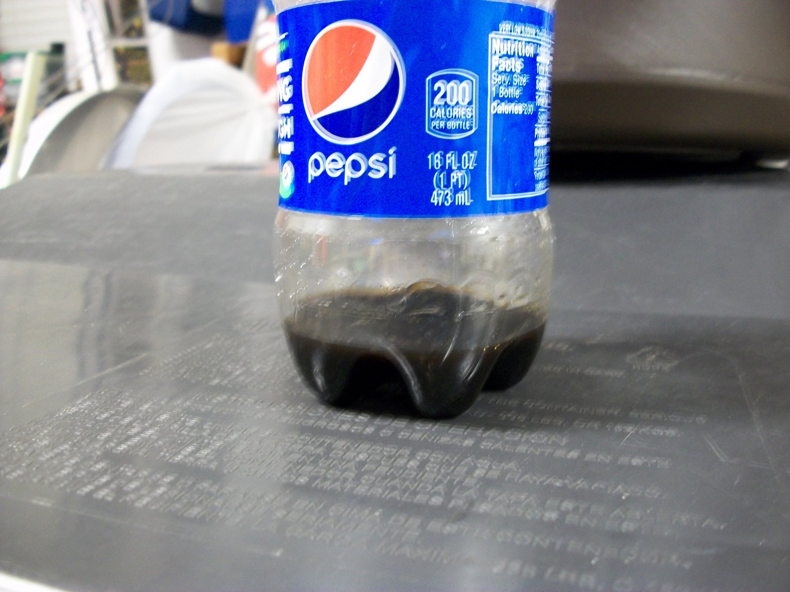

Most definitely.
I also had Justin turn my AFM off when he did my in person tune and I don't get nearly as much out of my catch can during oil changes as I did before. Good indication that the AFM has a lot to do with oil consumption.

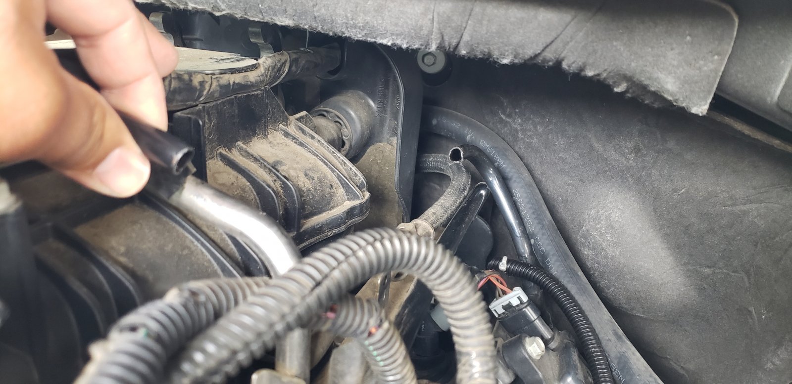

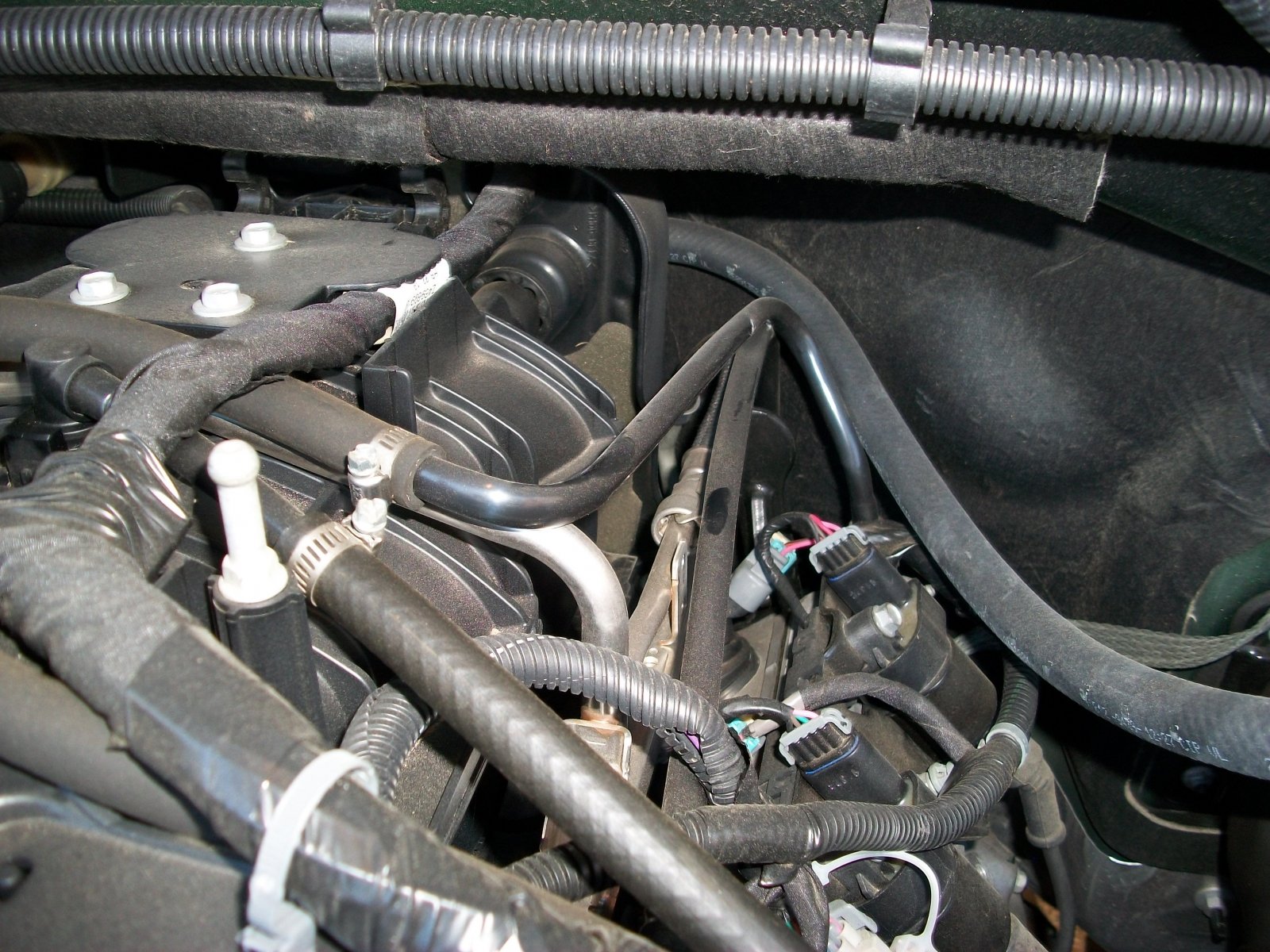

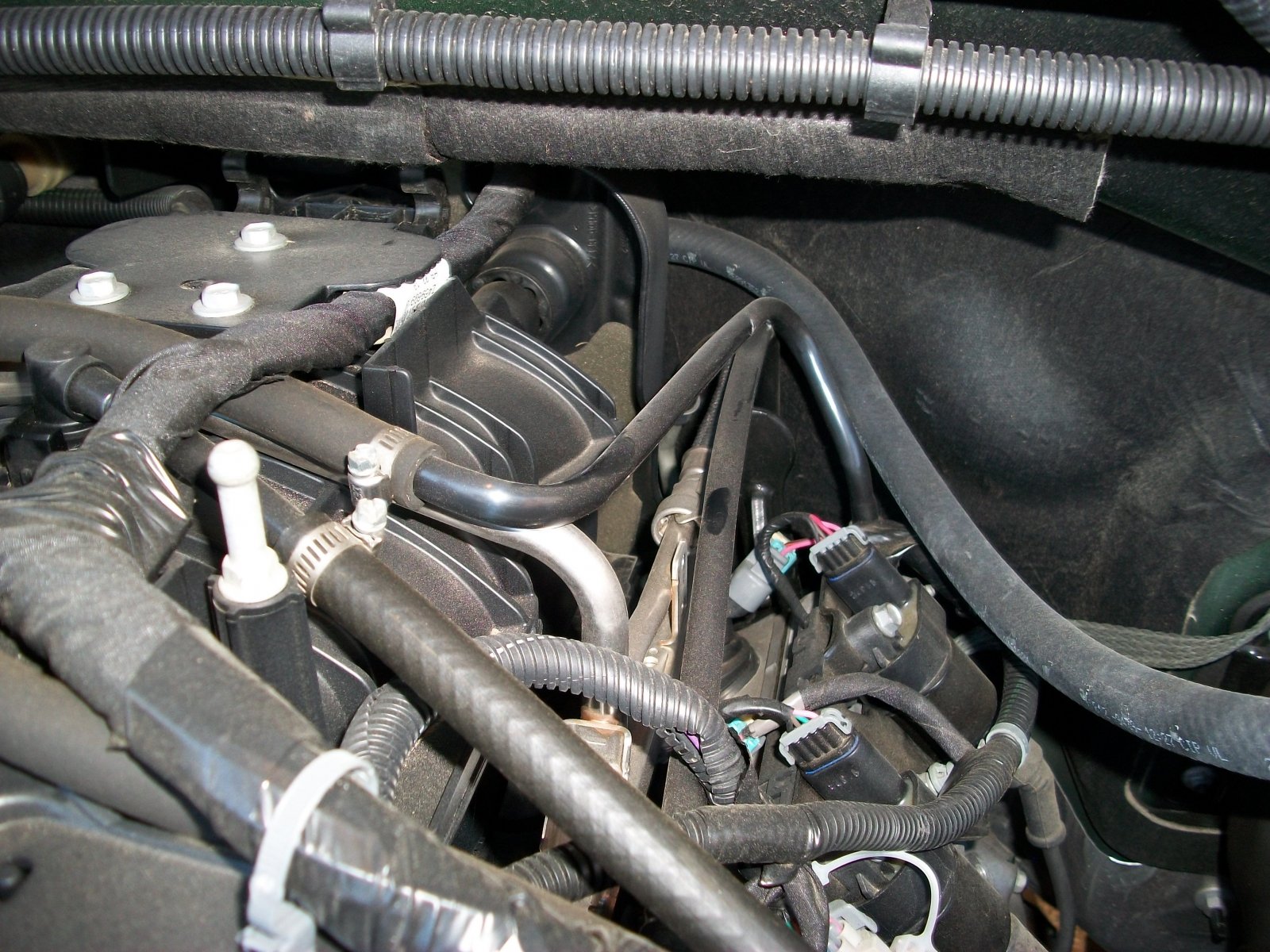

I Just used the stock fittings. Shouldn't be that hard that you would break fittings
---------- Post added at 10:52 AM ---------- Previous post was at 10:51 AM ----------
You didnt twist the fitting did you? It should twist off if i recall correctly.
---------- Post added at 10:55 AM ---------- Previous post was at 10:52 AM ----------
Or you could just snip the plastic pipe in two, swivel the ends around and slide your 3/8" hose on and clamp them. If you decide to remove the catch can system, a simple 2" piece of hose will make a splice joint to put the stock pipe back together.

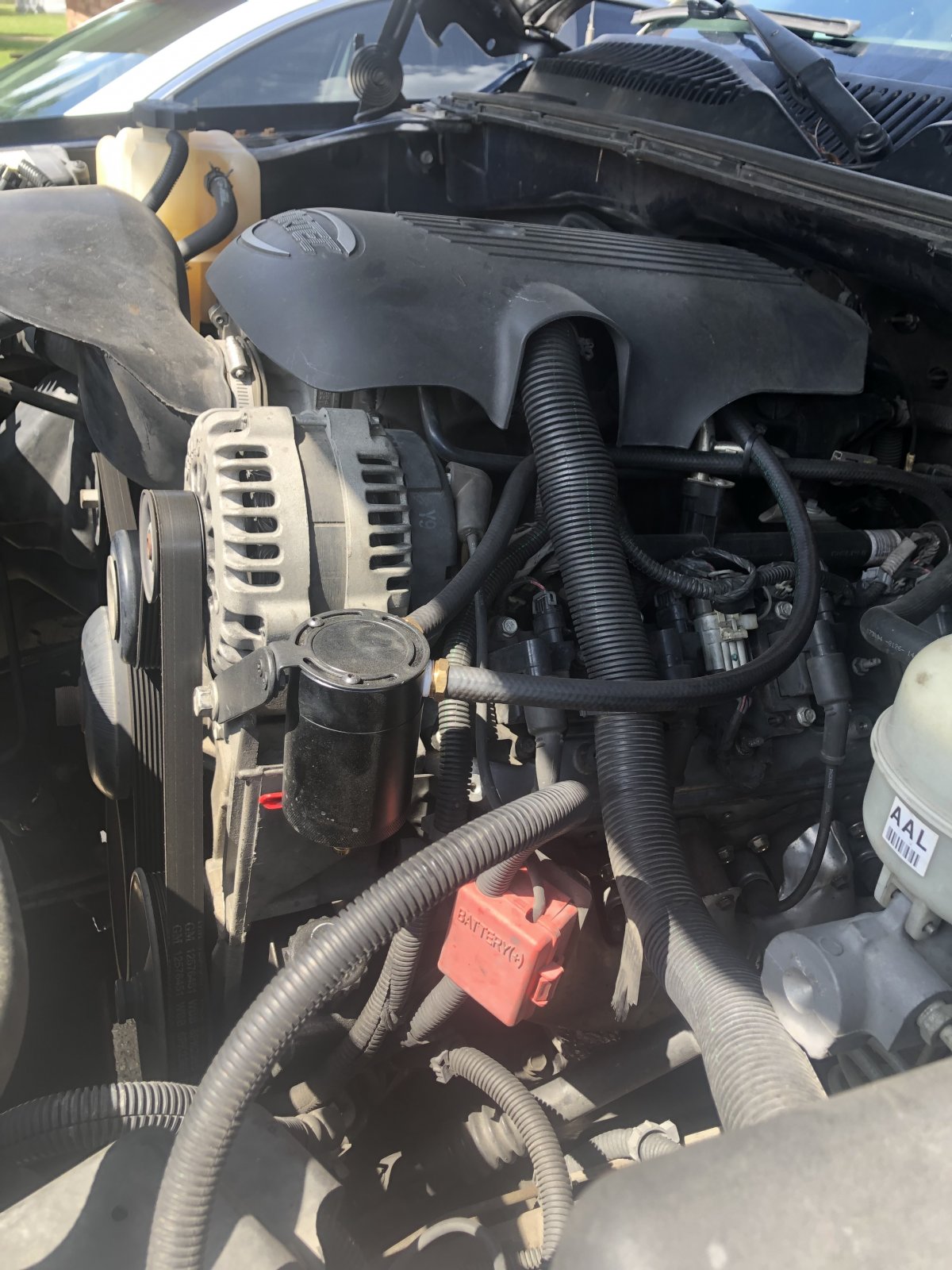

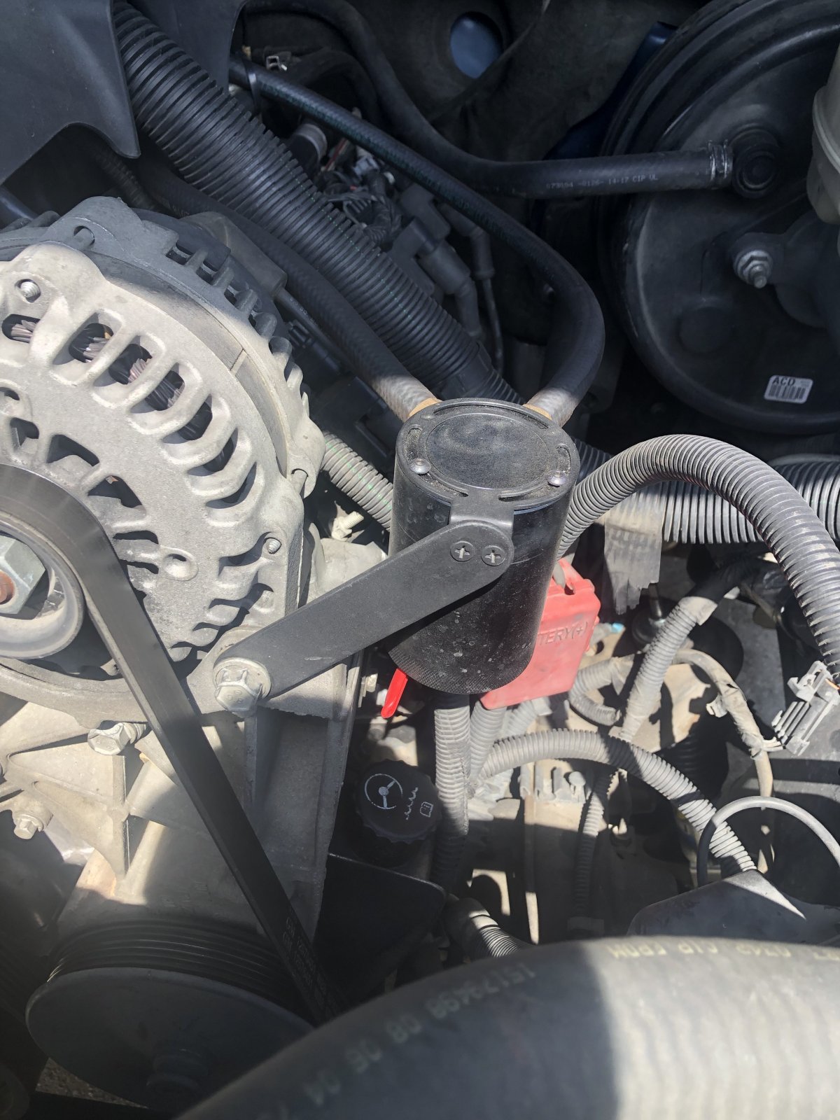

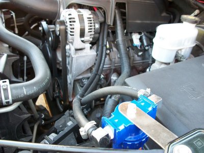

I'm running two in series right now (just because I can) and either of these locations are good. Some folks run them on various places on the engine, but outboard is better for oil collection in a cooler place. But that's just me.
Anywhere is better than not having one at all. JMO
