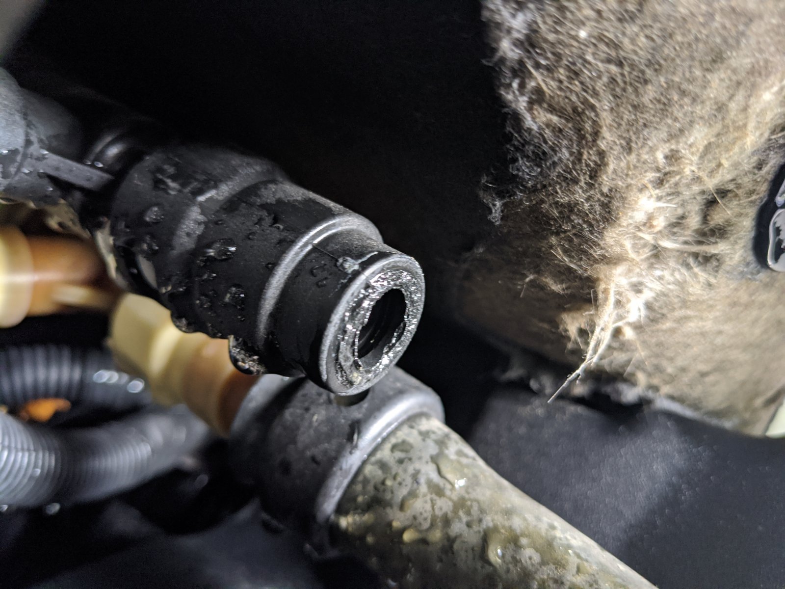

I was unable to post this photo of the connector that I had to cut out in my previous post as an edit, so I'm posting it here in a new post.

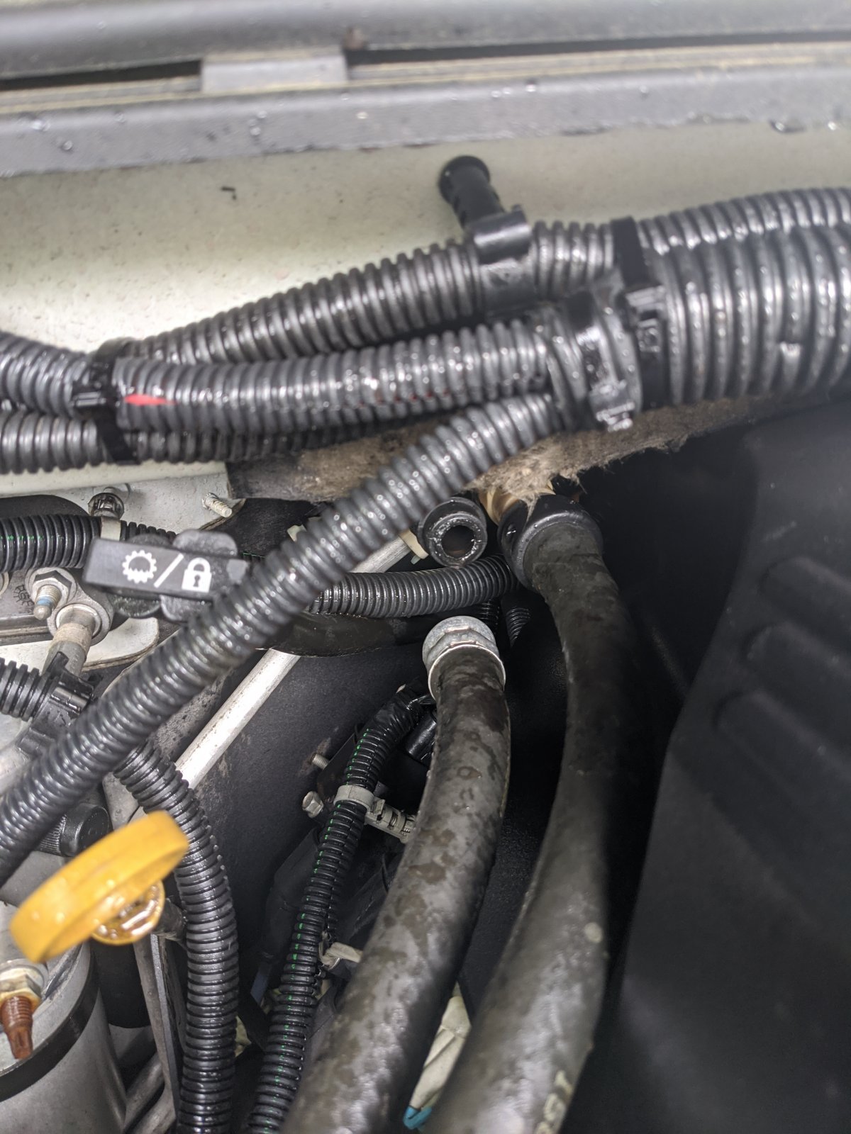

The easiest way to do deal with that is to snap those small flat tabs off of each side and then you can either pull the connectors off or or keep snapping some more of the plastic part off until you can get them off, I would replace both hoses and "T"'s with new oem ones seeing those lasted over 10 years. the problem is common due to age and from heat/cold.
Does anyone know THE OEM part numbers for those quick connects at the heater core? I couldn't find them on gmpartsdirect.com
Sent from my SM-N970U1 using Tapatalk
27,531
41,810
Thanks for the reply. So does the denali only have the t-fittings? Or does it also use the straight connector too?
all the suv have the T only the silverado's/sierra's use a straight connector, unless it's a older 2 door or something pre 00
