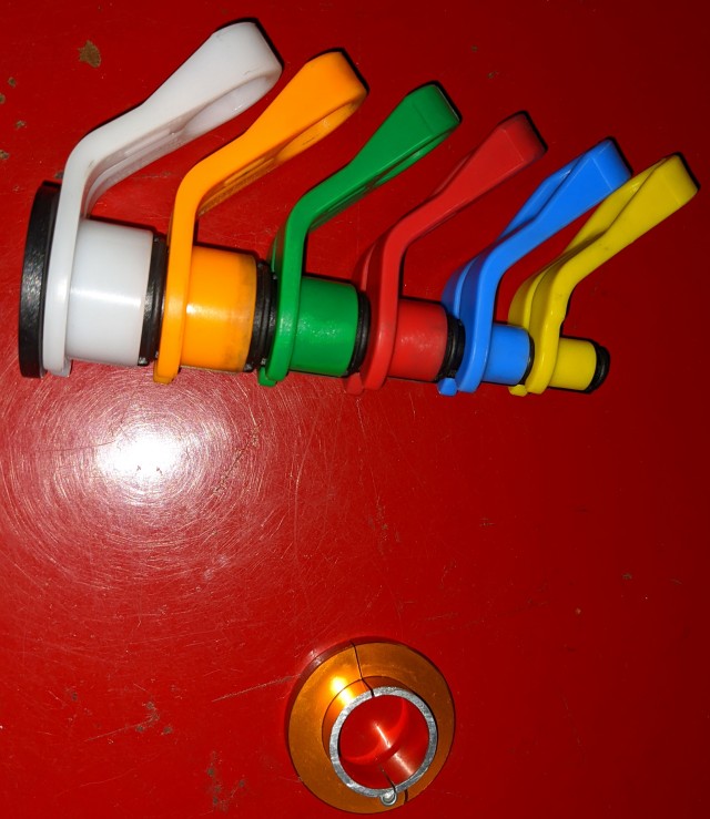

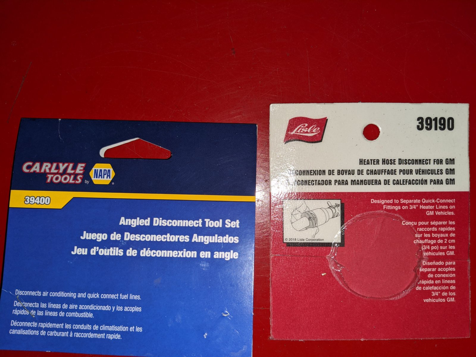

Hi Folks,
I just had a heater hose blow out on my 07 Yukon XL Denali. As the photo shows, it appears to have literally 'torn' itself off, right at the back side of the crimped coupling on the end of the hose, as it looks like there is still hose within the crimped coupling.
Question for you.... Do I need a special tool to get the crimped connector off of the plastic nipple of the coolant distribution block? If so, where is the best place to buy the tool? Part number?
Does it also make sense to change out both heater hoses, along with both radiator hoses? Any other coolant-containing hoses that should be changed out, as well?
All suggestions welcome.
Thanks in advance.
