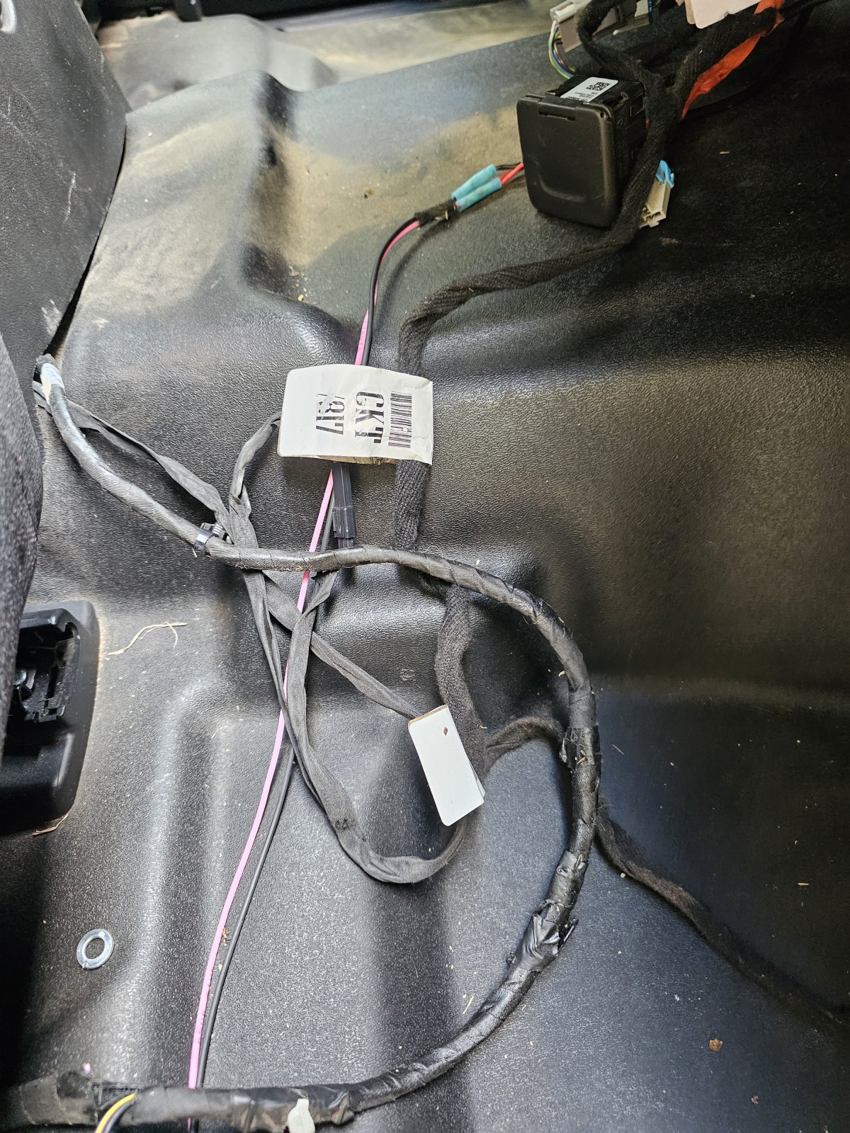

This is what I have

Ok you're missing a couple. Do you have a console in the vehicle? There could also be some looms coiled up and tucked under the dash right there above the trans tunnel or under the dash at the pass side and drivers side. I'll get some pics of the other bundles that I have

So in that pic of your cut wires, some of those wires belong to 6J3 as seen here:
Nutro
Jul 29, 2015
97
106
You need to find this wire/bundle which is brown with white tracer and a disconnect. This is your horn circuit.
Nutro
Jul 29, 2015
97
106
Does your WX7 have a terminal on it or is it cut? That pic you posted looks to be the 6J7 bundle but its only 5-6 wires and you bundle has a bunch of wires in it.
