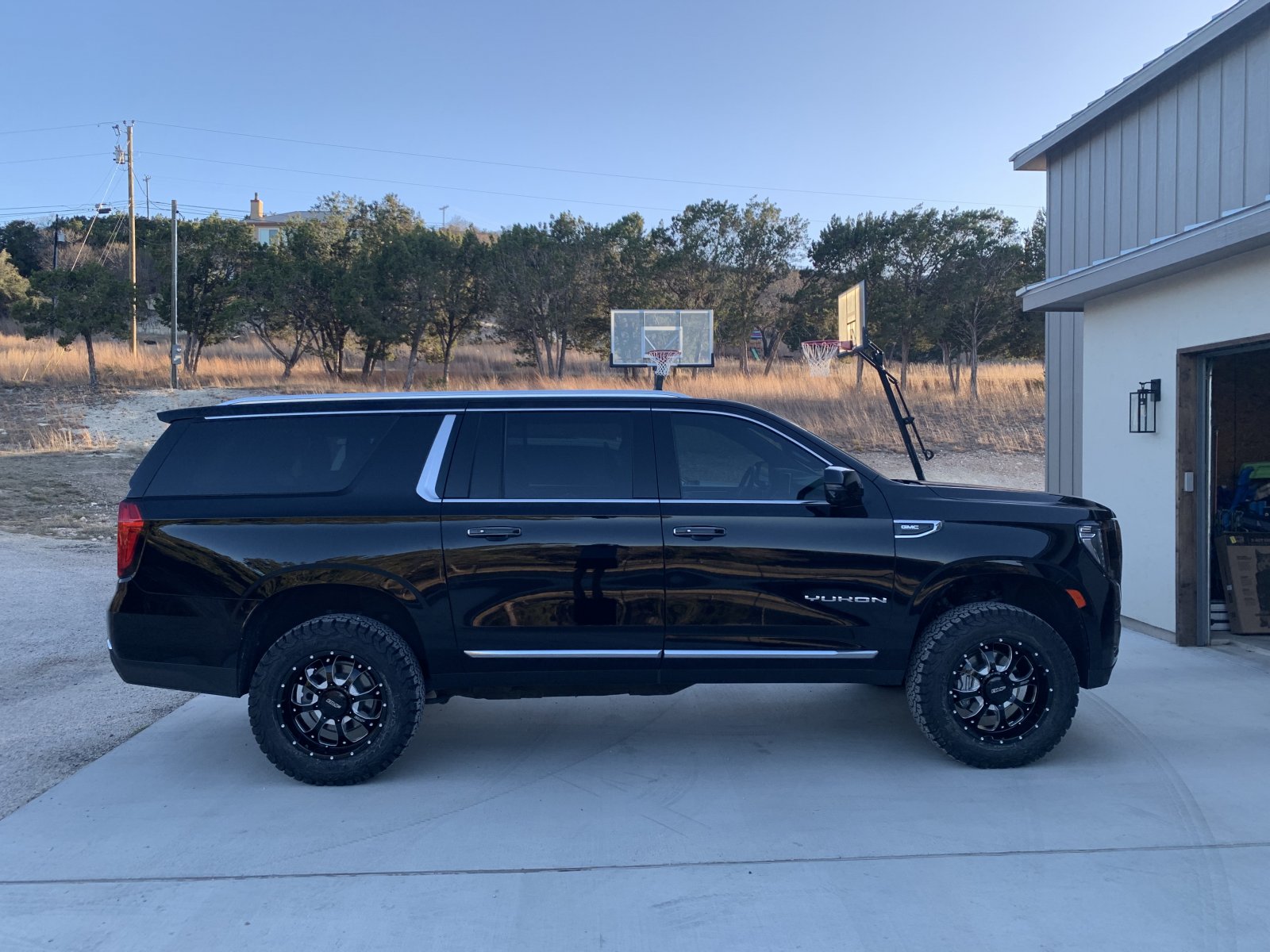

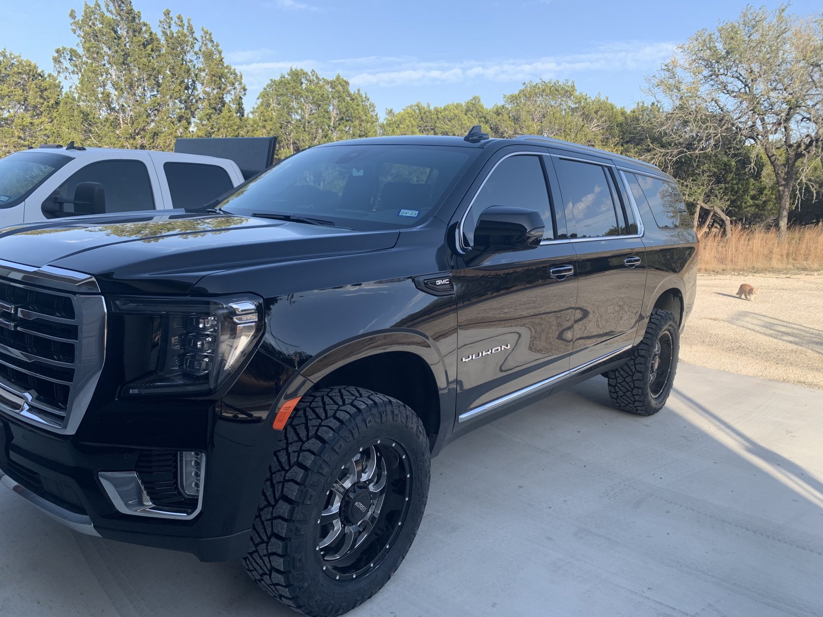

Had a RC 2” in the front and 1” in the back installed today. Stock rims and offset with 285/65R20 Ridge Grapplers. ‘22 Yukon XL AT4 with no AR. Minor rubbing on the inside of the fender that I need to cut. What’s odd is that it sits around 1/2” higher in the front. May need to add another 1” in the back.
What are your front and rear measurements from center of wheel to fender lip? We have that kit on our XL SLT and it's 22.5" front and 23.25" rear. Or 38.25" front and 39" rear from the ground to fender lip on stock size tires. Either way it ended up 3/4" higher in the rear
