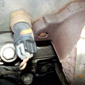

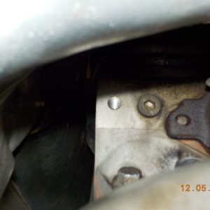

no pics???
BEFORE
GreyStone
Feb 18, 2020
896
995
Awesome pics - thanx Don!. So - are the broken bolts left in the manifold? Would these same clamps work on a 5.3?

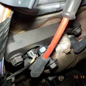

Wanted to update this thread and provide some closure.
I bought one of those clamps and put it on the front area of the manifold (where one of the broken bolts was, and where I felt the noise was coming from). The ticking was immediately gone on cold start - I've now verified it 5 times. I was mistaken to blame or even point a finger at LiquiMoly. Their snake-oil is not to blame.
I will continue using it since it is very cheap for me and seems to be a very high-quality oil.

I did all the snake oil stuff you referred to... Including the kreen. My suggestion is throw in a quart of atf and drive it like you stole it.
Also, I know you say you're certain it's lifters..... But like you've been told before it certainly could be an exhaust manifold leak.
