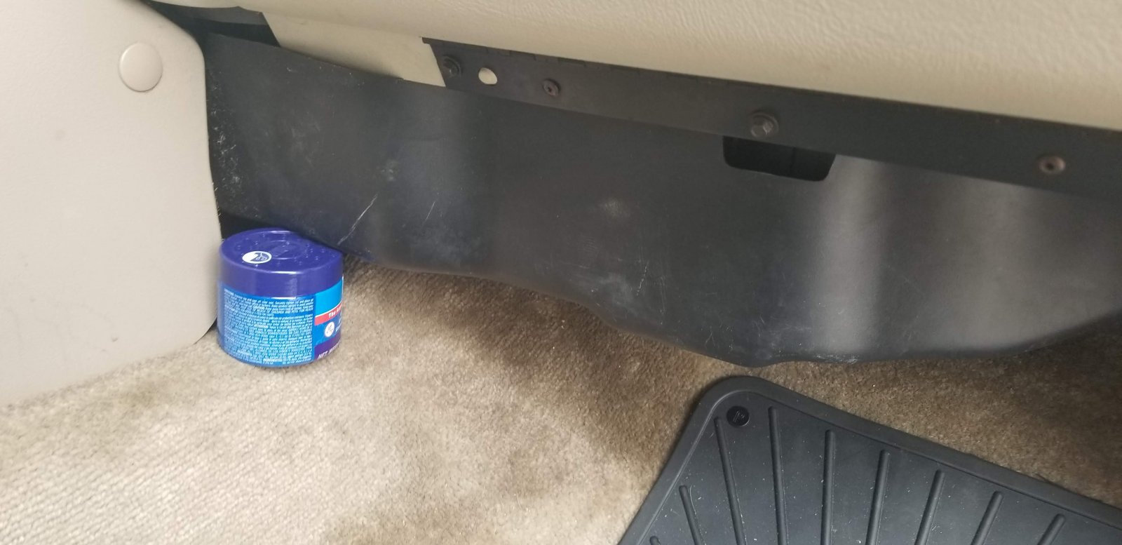

Wanted to post an update. I got the Meguires Black Chrome scent bomb. It seems to have done the trick. Its only been a few days but i don't smell the tar funk i was smelling. We'll see if it lasts.
F
Flingflanger
Mar 30, 2020
60
53
Update to the update.
The Megurires has lost the war. They won the first battle but today i got a huge whiff of funk. I think it might take at least 3 of them over a week or two to totally get rid of things. I might try the ozone. I've seen spray ozone called Ozium in the past. Maybe that'll work.
