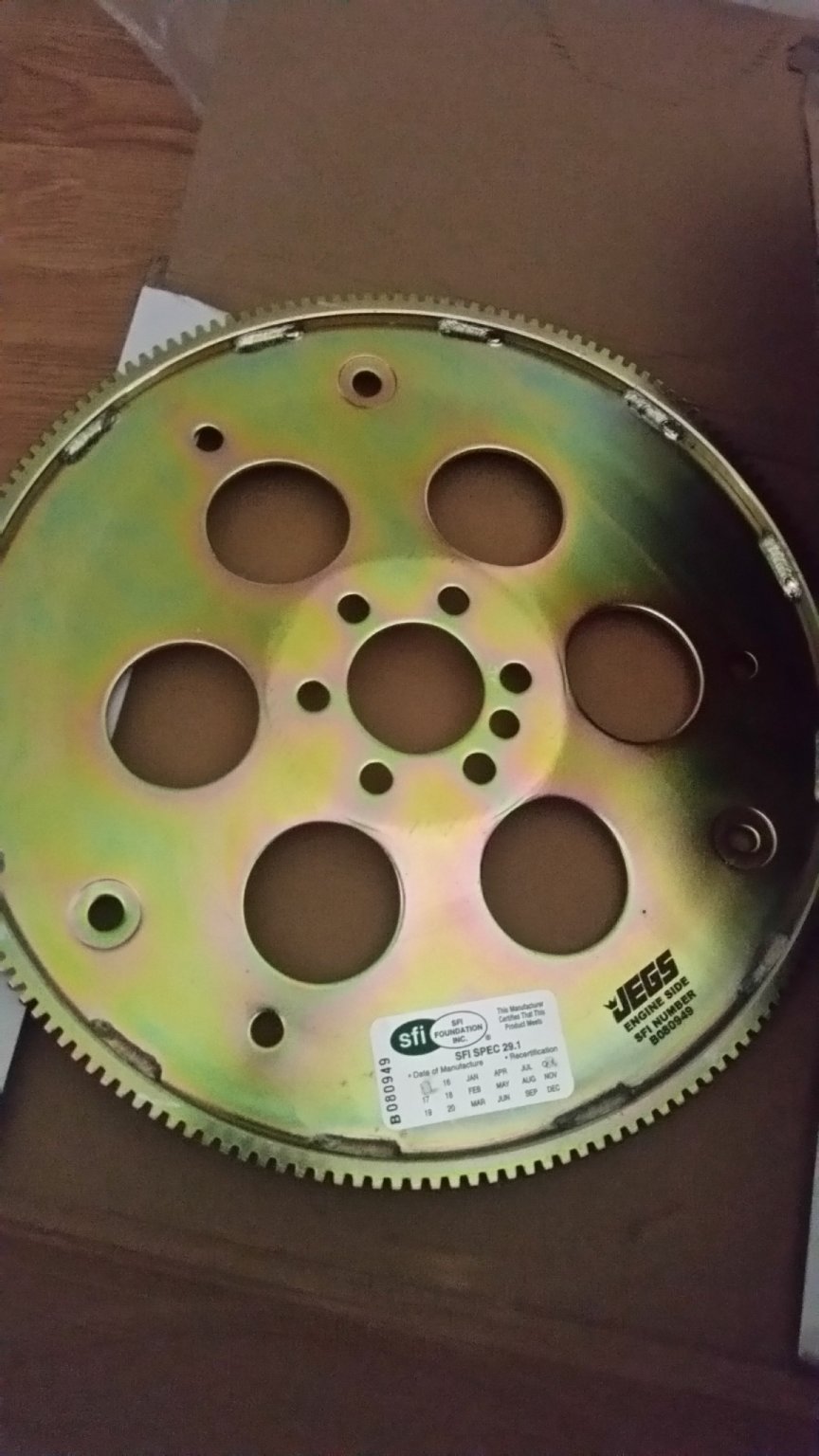

Thanks man and yeah there were a couple of issues and all trans related. First was the flexplate install and almost cross threading one of the bolt holes. My engine came with a 4l80 flexplate and I switched to a 4160 plate. I tried to use one of the 80 bolts to break up some of some of the thread locker/oil deep in the crank and it caused a bur in the threads since the bolts use a spacer and don't thread all the way to the top of the bolt.. the ARP bolts I used fit tight in that one hole and I almost stripped it but it worked out and torqued down fine after a nice scare..uploadfromtaptalk1450539197086.jpguploadfromtaptalk1450539230945.jpg

Second Do you have a part number for the Flexplate and flexplate bolts are you also on a 4L80?
