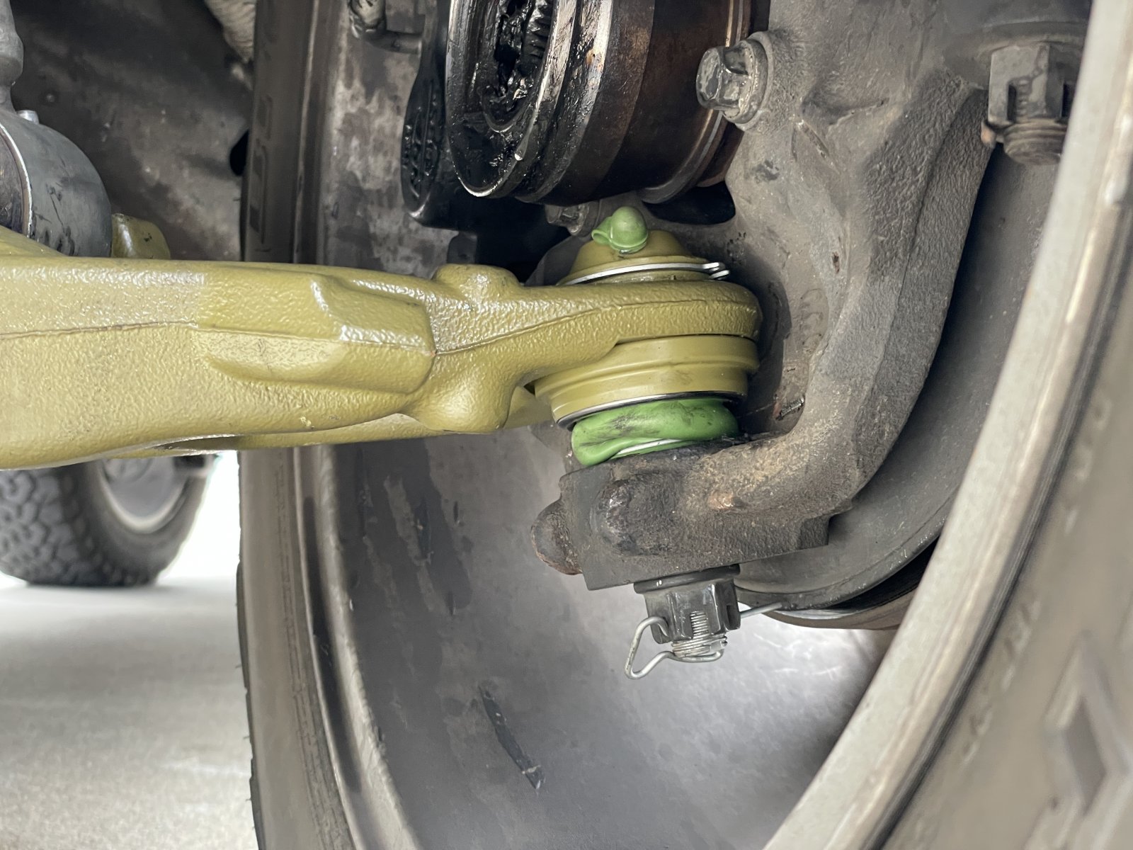

My kryptonite boots are still holding up… tried to tell ya!Installing my Mevotech TTX lower control arms today, just installed their upper control arms like a month ago and the boot it already coming apart.
Also just so you know kryptonite wheel bearings are pressed style bearings so you can run them without those cv axle tips in unlike the stock ones where if you don’t run the cv axle it could split apartNotes on the lower control arms. The zeros are facing forward without the ability to adjust that without repressing the ball joint but they do include zerk covers.
The lower ball joint boot seems to be turning with the knuckle in the picture you can see the boot it kind of twisted.
