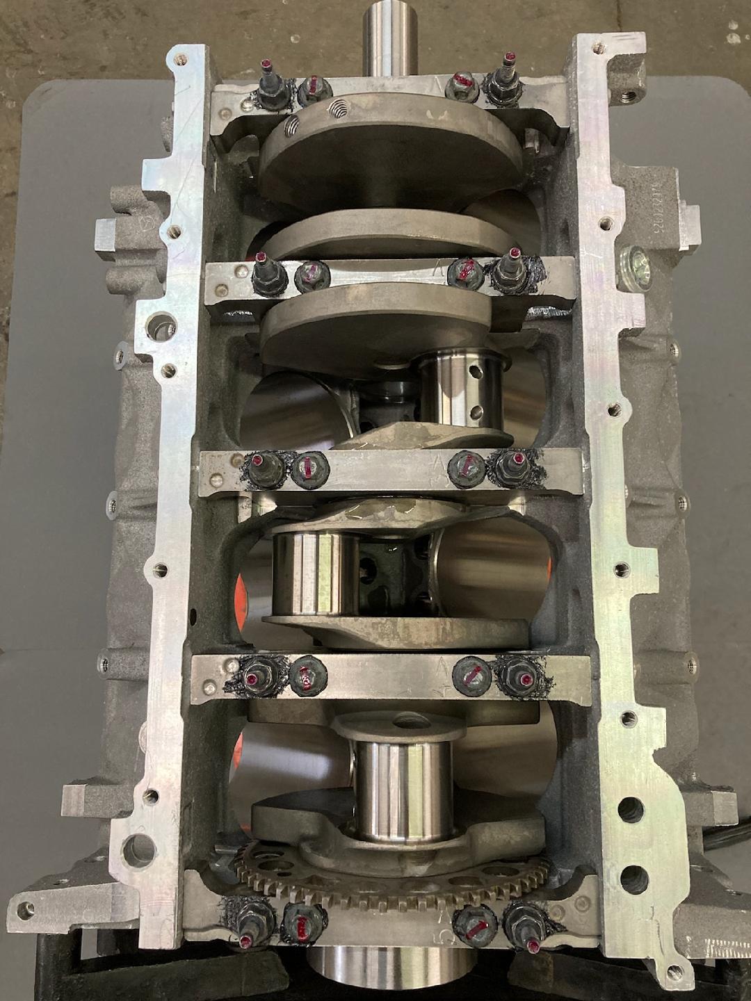

The valve seat broke in half and dropped into the cylinder. Half of the seat was stuck in the intake valve and wouldn't allow it to shut, lol
I'm gonna look for a new short block I think... I'm just still in disbelief that it happened and I hadn't planned on this contingency, lol.
