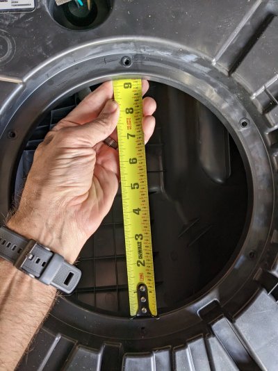

Thanks for everyone's contributions here. Made it easy to add the Esky box to my 2021 Tahoe. After reading reviews of the AKG system in the Esky, and their struggle to find a sub that will fit, I figured the stock sub with a little power might be be worth a try. It turns out it is pretty disappointing, so now the search begins for a sub that will fit. Here are a few photos with measurements, to help anyone looking for sub options.
