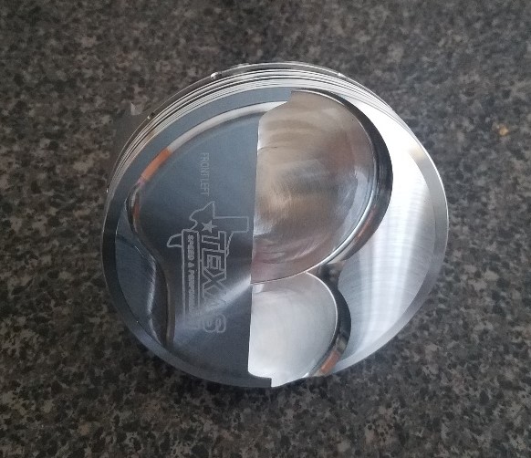

Talked to Texas Speed this morning and walked through some questions after receiving my assembly. Quite frankly, the main purpose was to ask about the pistons. I wanted flat top pistons, but they did not have the particular brand I originally ordered in stock. Recommended a different brand (next up in quality) for the same cost. I opened up the box, pulled out the paperwork and read the word "dome" in the balancing portion of the paperwork - however they did have the same net piston volume. Immediately went to the box and pulled out a piston. They are beautiful by the way (I will post pictures later) but they did not look like a "true" flat top. After talking to Derek, my concerns were put to rest. He also answered the numerous questions I had after reviewing the paperwork. Looking forward to putting this thing together - but will be taking my time.

A picture of my new piston. I got started working on the block a bit. Chased threads and starting installing plugs and caps.

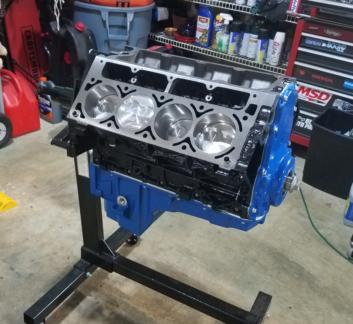

What compression ratio will this be?
Been awhile since Ive done engine work.Plasti gage to check journal clearance etc,I still have the old school piston ring compressor and a manual torque wrench.

Working with Texas Speed on the heads I will use. I currently burn 93 octane with my current engine and build and I don't plan on that changing. I was planning on using heads I currently have on hand but decided to go with something nicer. Looking to be around 10.5 to 1 up to 11:1. This became more of a LQ9 build with benefits. I also went with fully floating pistons/wrist pins with my upgraded pistons and connecting rods. I have plastiguage on hand and will be checking all bearings.

so this will be an interference motor or not sure what you call it when valves come into pistons? Its been so long I cant remember.Some pistons actually come out of the block a hair there's a name for that?
Babbling on,cool stuff.

It would depend on the cam that is used (and of course the piston). The particular cam that I had custom made from Vinci High Performance will not cause that issue.
