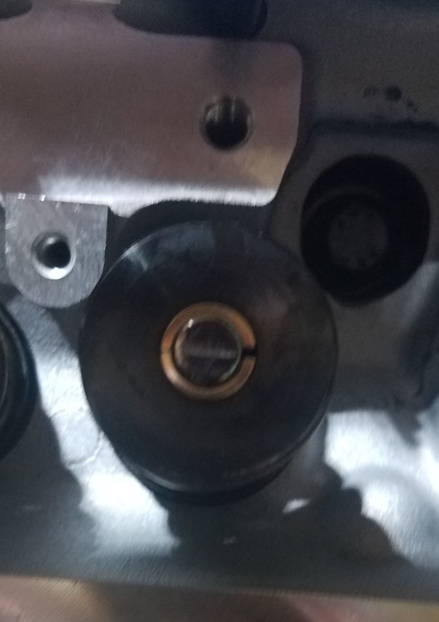

Sorry for the lack of pictures, but it was a bit of a crazy afternoon. Hot and humid and my garage A/C stopped working. Need to get that fixed ASAP. Was able to get off work a bit early this afternoon so I started the process of confirming my pushrod lengths. First I ensured that the rockers were centered on my valve stems. The attached picture shows that I'm centered on the valves. This is the exhaust. The intake was centered perfectly too but the picture was not as clear.
I did not have prussian blue so I painted then valve stem with a black marker. Torqued the rockers down with standard 7.4 inch pushrod installed, rotated the driveshaft several turns and then removed the rockers, Perfect geometry.

After verifying multiple times and multiple ways, it looks like my pushrods need to be the exact length that Roger from Vinci Performance calculated - 7.425. Actually, my calculation was just a bit shy of that, but you round up from that calculation. Will get those ordered tonight.
