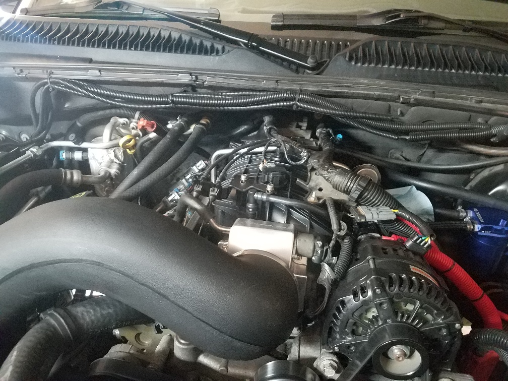

So the rest of my fittings were delivered. This is the final product. Looks great, takes up much less room than other solutions I have seen. Thanks again @Rocket Man . Hopefully, there will be no leaks. Now I have everything to install this bad boy. Just need a tune from BBP. Still have not heard from them yet. I will reach out again tomorrow morning.
