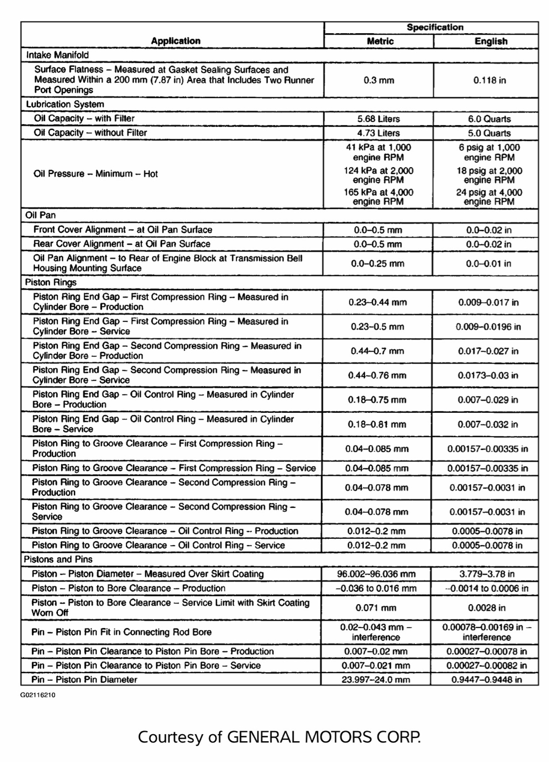

What is the normal oil pressure range for a 6.0 Vortec? At idle and under acceleration

What year are you working with
Thanks, was just curious it's an 04 Esky 6.0 has 160k and change idles a lil under 40, and going down the road it's 40+ about the same as my 03 Silverado with 116k

Idles a lil under 40, and going down the road it's 40+
You might want to do a quick test. Turn the ignition to the run position without starting it and watch the gauges energize. If it oil pressure needle sticks at ~40psi with the engine off (i.e. no pressure) you have a bad oil pressure sending unit. Mine was like that when I bought it with 156k. Cheap part to replace, but it is on the back of the block against the firewall. I watched a few youtube videos and did it all by feel while laying across the top of the engine. Now it reads accurately, and actually changes between idle and driving.
