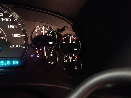

Checked that today, I clamped the hose from radiator to the surge tank, and drove for 6 miles. I saw the temperature rise and when the thermostat opened, at above a quarter of the gauge, it dropped. Then the temperature rise, drops, rise, drops and was fluctuating between a bit over a quarter and a bit below half. When the engine was warm and stable it continued fluctuating. Then I released the clamp, to see if there is a difference. No change.
Maybe rockola1971 is right and I have a problem with my new thermostat..
What i wonder:
How our trucks react normal with engine temperature? This is my second american car and I know it from German cars like Mercedes or BMW, that temperature rise and then stay nailed in the middle of the gauge, anyway if you drive slow in winter, or 250km/h on the highway in hot summer.
I have a Chrysler LeBaron convertible and i know from many other LeBarons in our community, that the temperature fluctuates as well.
How is that on our engines? Or is that normal at American cars?

Under normal operation the truck will run about 200 degrees. The gauge on the dash should park at just below 210, like a hair below the 210 mark. I’ve heard a lot of guys here say that actual running temp with a scan tool hooked up will show about 199. It shouldn’t move while running especially after more than 10 or so miles depending on ambient temp. It should stay at the 210 mark on the gauge once it’s warmed up so it’s definitely not normal to see it fluctuating. The only time mines runs colder is when I’m driving down off the mountain I live on to the base area below. We have three highways in and out of town and the primary highway I use only has one little stretch of tight windy corners where I’m using a mix of throttle and letting off to get through that stretch. The majority of the highway is long sweeping corners that are properly banked where I’m doing about 50ish MPH, and when going down the truck is just coasting down the grades in 3rd gear, so it’ll drop from the 210 mark to 180ish because I’m not using enough throttle and gravity is keeping the truck moving. Unfortunately hurricane Hillary rolled through socal in late august and brought tons of rain and heavy wind that took a huge section of the highway, so it’s been closed and under repair since. With no projected opening date. So the last few trips I’ve had to take the other highway, what we refer to as the “frontside” and it’s much more windy and twisty and average speed is 35-40 MPH through most stretches. Ironically there’s longer stretches that tend to be more flat as it travels through a couple little tiny towns, and the grades are below the town. But even on that highway through several portions where the truck is just coasting through corners the temp will drop to the 180 mark. But it’ll go back up within a couple minutes of throttle to stay moving and then will stay at the correct temp.

The gauge circuit is programmed to be a bit "stupid" in that once it gets to the middle range it's not going to fluctuate much over a 10 or 20 degree range. If it did fluctuate and was highly accurate people might panic when they see it moving around. Generally the display is like @adventurenali92 stated, and remains the same indication (in the middle) over a fairly wide range of the operating temp.
