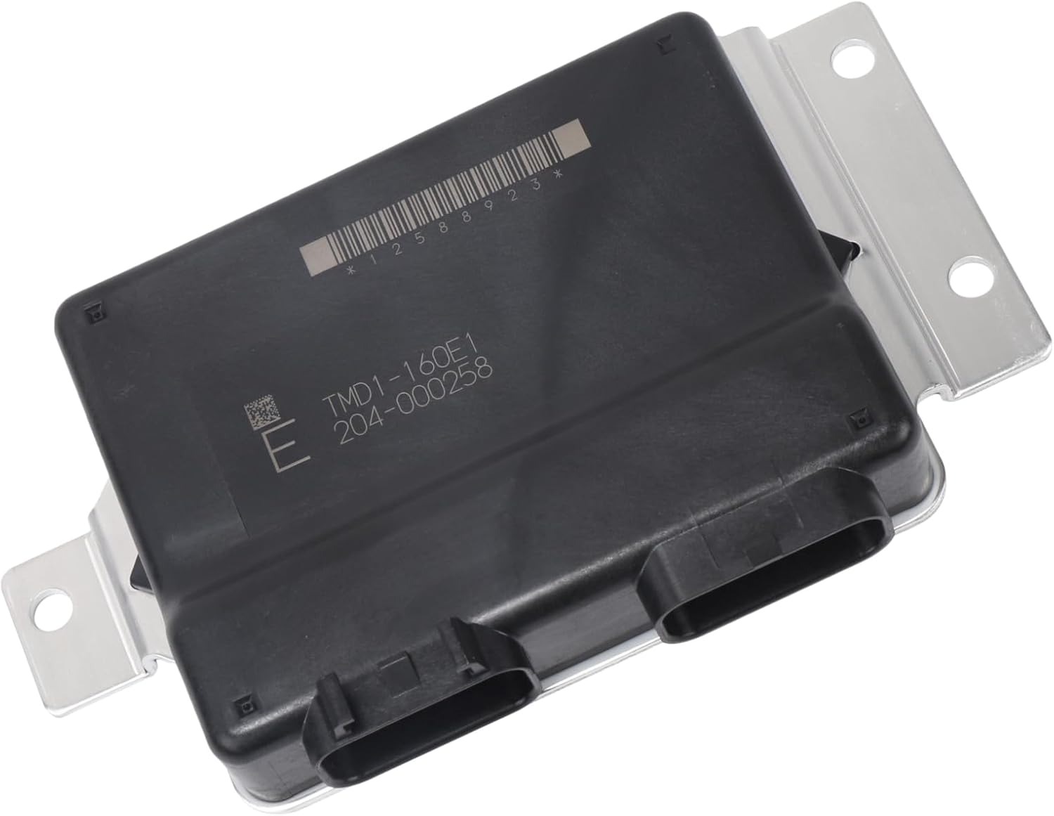

You can bet there's a circuit or module issue because when you turn the key to "run" without starting it, it's already sensed that something's wrong. It's tested the circuits in preparation for startup and found something lacking.
In addition to confirming that the grounds are clean and solid, check the connection at the TAC.

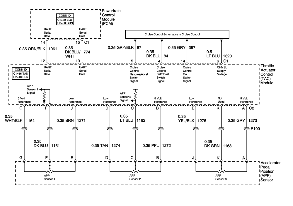

Here's the troubleshooter for P1518:

Another failure point is the wiring harness that plugs into the TAC module. It plugs in at the bottom so the wiring harness just dangles off the plug under its own weight. The common breaking point there is one or more of the wires right where they enter the plug body of the harness to the TAC module.

I swapped out the harness some 30 or 40k ago and all has been well since. I just cleaned all the grounds again and checked under the fuse box as well to see if there were mouses chewing up wiring. Took TAC off and sprayed the harness and TAC connection points with electronic cleaner. Put it all back together and still same problem. By the way I appreciate all your feedback! Thanks again. P1518 the minute I turn the key on. Now when I erase it and start it up and all is well, it wont do it for awhile. But it always comes back after a bit. Much quicker than other codes I have had. I ordered a used TAC on ebay. We'll see if that might be the issue. The thing about my other codes is that it would grow gradually and get worse over time. This one was immediately bad and has never changed. So it should be easier to locate you would think since it is easily repeatable. So hopefully the TAC is the issue. For $30.00 it doesn't hurt to try. If you guys think of anything else, please let me know. Thanks again.

Thanks for the link. It may be a bad connection between the PCM and TAC. Maybe I will pull of the connector at the PCM and see if there is corrosion in there. We will figure this out.

DIAGNOSTIC AIDS
- DTC P1518 sets if the battery voltage is low. If the customer's concern is slow cranking or no crank because battery voltage is low, ignore DTC P1518. Clear any DTCs from memory that may have set from the low battery voltage condition.
- DTC P1518 sets when there is a short to B+ on the TAC module ground circuit. Inspect the fuses for the circuits that are in the TAC module harness-i.e. cruise, brake. An inspection of the fuses may lead you to the circuit that is shorted to the TAC module ground circuit.
- DTC P1518 sets if the TAC module ignition feed circuit is shorted to a B+ supply circuit. The TAC module stays powered-up when the ignition switch is turned OFF. When the ignition switch is turned ON, the TAC module is powered-up before the PCM. DTC P1518 sets because no communication is detected by the TAC module from the PCM. Inspect related circuits for being shorted to a B+ supply circuit.
- Inspect the TAC module power and ground circuits and the TAC module/PCM serial data circuits for intermittent connections.
- Inspect the TAC module connectors for signs of water intrusion. If water intrusion occurs, multiple DTCs may set without any circuit or component conditions found during diagnostic testing.
- When the TAC module detects a problem within the TAC system, more than 1 TAC system related DTC may set. This is due to the many redundant tests run continuously on this system. Locating and repairing an individual condition may correct more than 1 DTC. Remember this if you review the stored information in Capture Info.
