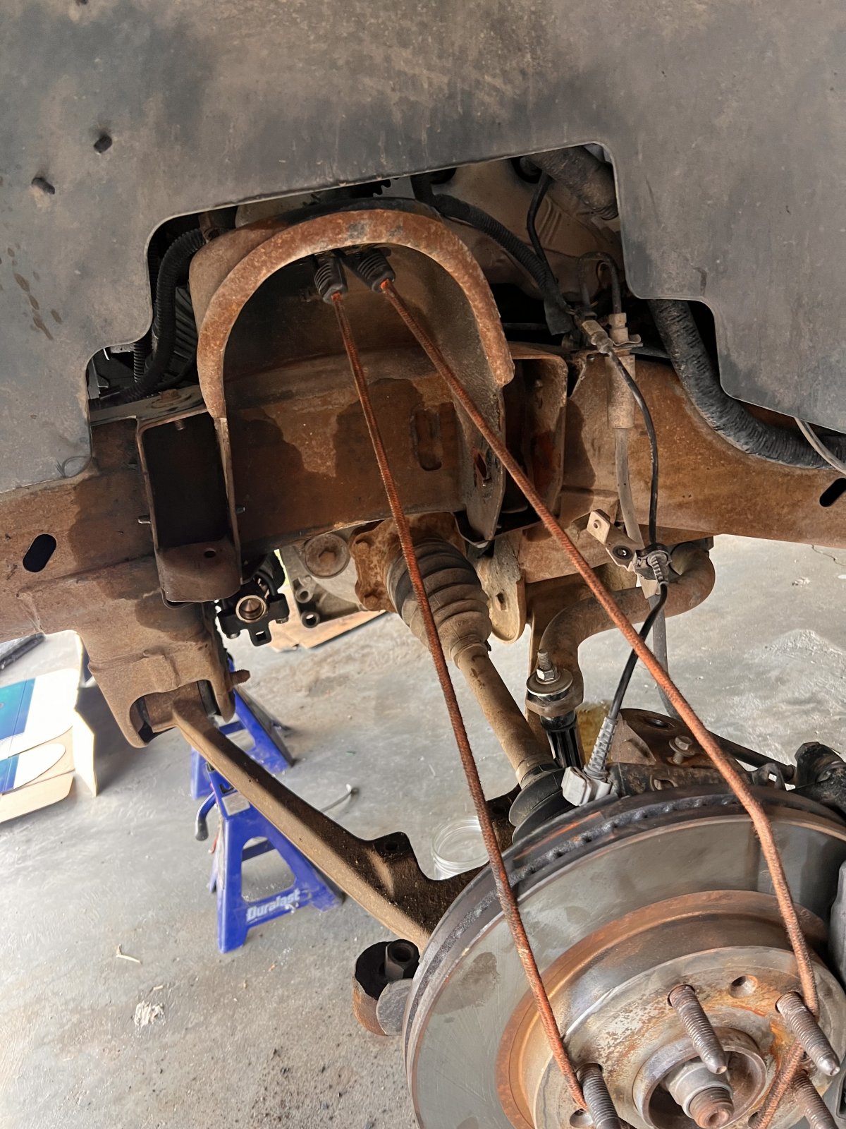

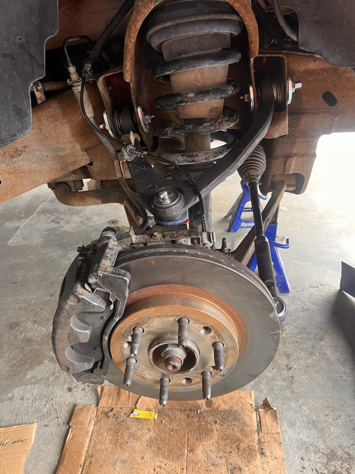

Working on the front brakes. First one is done. I had to drill out the rusted rotor screw. Couldn’t get it out even with the hammer punch and ultimately ended up stripping it.
New rotors didn’t have new screws. So my question is, best place to get new ones? And is it drivable without them?
Yes, it is driveable without them. The lug nuts hold it all together. The screws are there so that when the truck is built at the factory, as the frame has components hung on it, the screws hold the rotor flat to allow for quicker install of other brake components and sometimes the frame is flipped over during all that process.
