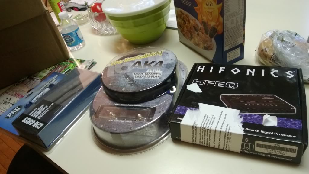

First of the packages came in today :D The rest will be here Thursday, the last one Friday at the latest...Install will be done (fingers crossed) by sunday!
My biggest problem right now is how I'm going to mount the tablet, I really love the simplicity of mounting it permanently..But I really wanna be able to take it in and out easily
