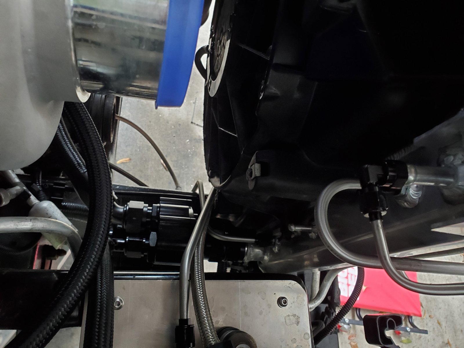

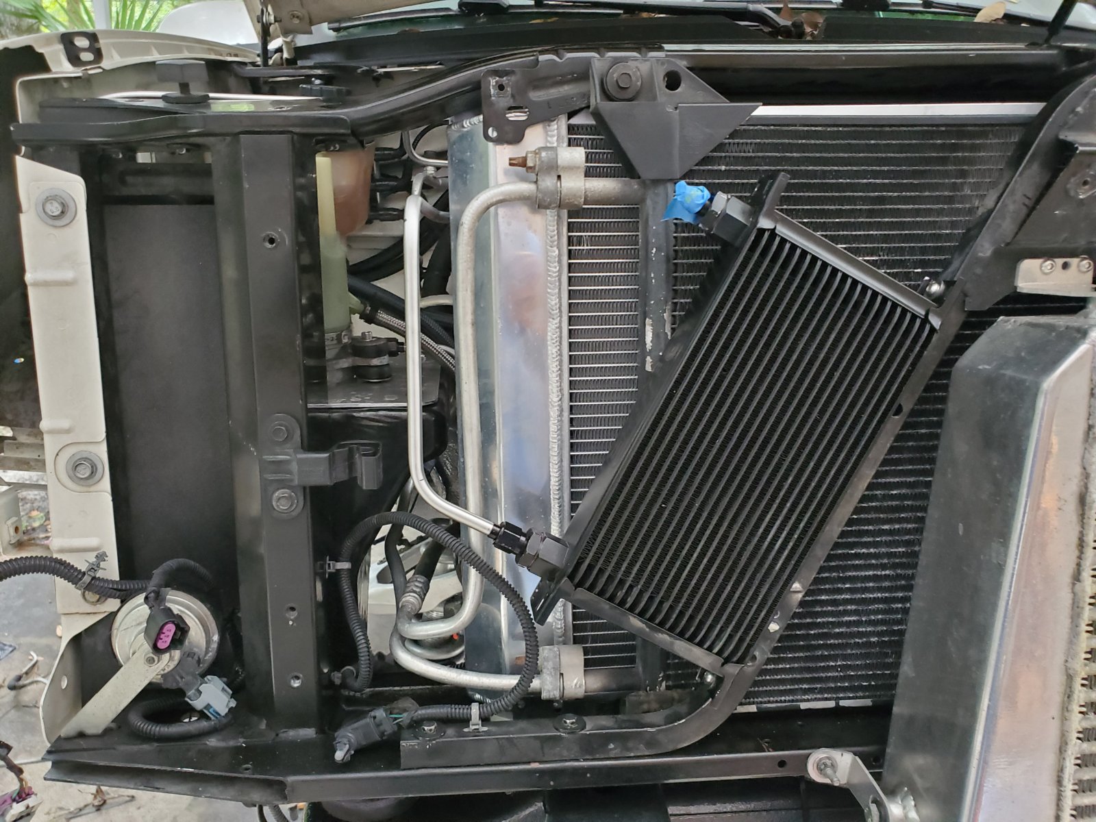

Not much else going on...ordered a driveshaft, started plumbing in trans cooler with what tubing I had.

Meh....
1st attempt: I tried to make a 180 off the top, over the top but bender would make a tight enough radius and it hit the trim.
2nd attempt: I tried to go pretty much straight out on the top and around the radiator (follow the other tube) but when I got back under the hood it was pretty much right in front of the turbo and would never get a filter on it.
This is what I ended up with...
