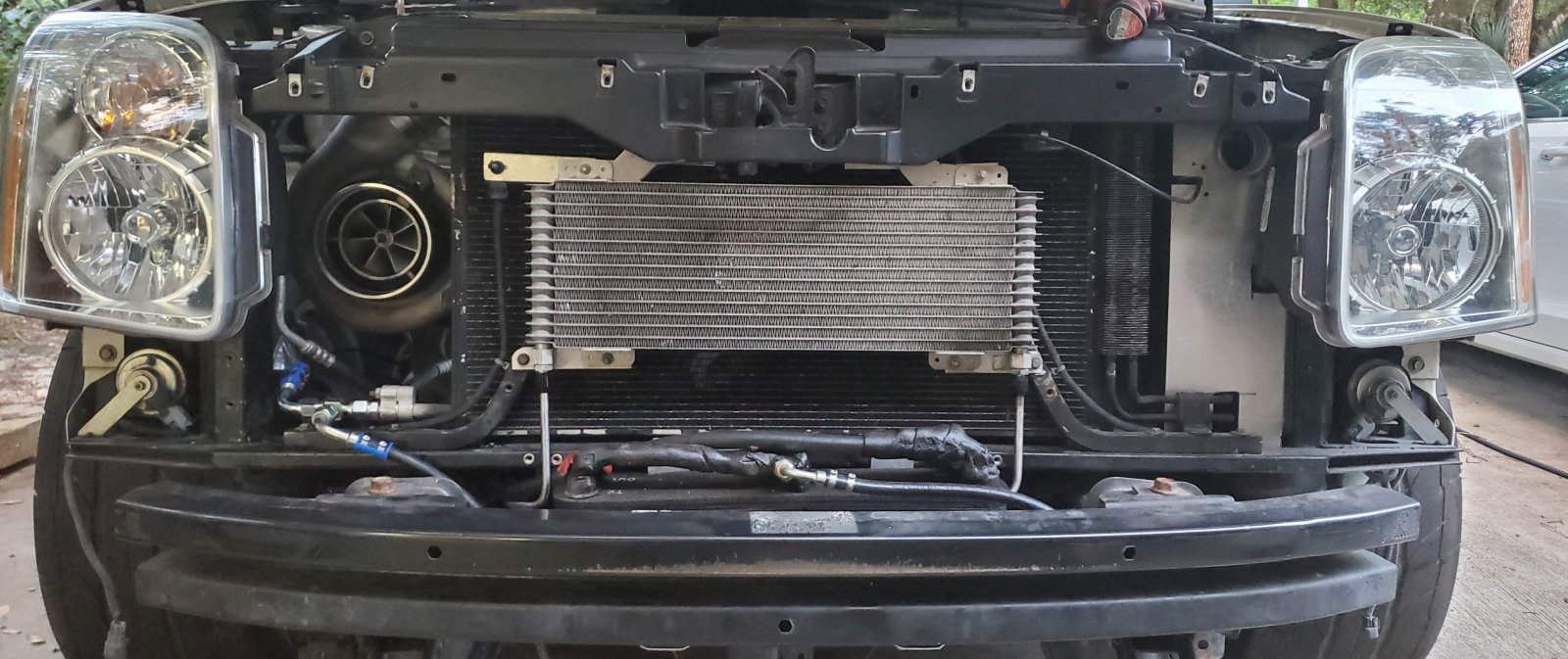

the transcooler that i installed is so-so. it'll stay maybe 15-20* under the coolant temp until i beat on it then itll come up to around the coolant temp. wants a lot of air flow to drop - i'll notice at like 45mph it takes a while, while at 80+ it takes just a few mins. the trucool 40k seems to work a lot better at keeping the temp down, the slim wide area does more than the thickness. havent seen anything over 180* yet so i'll prob just leave it and see how it works out.

I have the tru-cool on mine and the b&m deep pan and the highest it will get is 180, seems like it was running cooler last year maybe 165 unless I was really beating on it or maybe I am just being more savage with it again, it drops down to 145 or so fairly quickly though when I am not getting on it. Outside temps here have been pretty hot a lot of over 90deg days all summer

yep with the trucool it would hang about 155-160 on mine with a 3800rpm stall.
I am also doing a lot of low speed, short drives and constantly watching it so this derale cooler may not be that bad after i get done dialing everything in. 180* im really not to worried about as long as that is the upper end- also about the worse time of the year temp wise so it shouldnt ever be any worse than these few months
