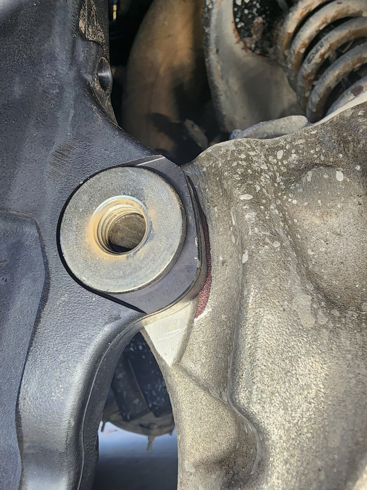

Are those the ppv brake calipers?
Yes 2021 ppv brakes, I have 2015 uca lca and knuckle
does need new banjo bolts, they are different thread than the 2012 gmt900 brakes. i had some from a waste gate that ar ethe right thread M10x1.0 but they are a little bit too short for me to trust them indefinitely. i threw them on just to close it up but it looks like the gm ones are m10x1.0 27.5mm long? the ones i had are maybe 20mm long. they thread and tighten but would like much more thread on them
