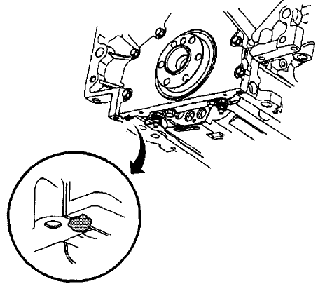

Anyway, i was looking at the design of the rear main and also the oil pan. I can now see how difficult it is to tell the difference between a leaking rear main and a leaking oil pan gasket. I may do the oil pan first and see if that solves the leak. So far, I can't find a method to determine what is leaking back there without actually taking things apart. Perhaps once I get the oil pan off I can get a mirror in there and look at the rear main seal.
Just so everyone knows, my oil pressure sender is new, replaced when going my heads, so I doubt that is leaking. The valley pan seal is relatively new as well. The oil that is leaking is nice and clear, running down the back of the oil pan, visible through the bell housing inspection plate.

You can spray some cleaner in there and get them blown dry if you have air or use canned air. Then add dye and drive for 5-10 miles and recheck with infra-red light for the signs of dye.

Is it even possible to look up through the bell housing far enough to see if the oil is leaking from the oil pan gasket or the rear main?

Well, you could use a small flexible mirror and a bright light or if anyone you know has anything like a bore scope you could use that. If you are inclined to not have to do the rear main seal if not needed, I would try anything to pin point for sure.

Okay, it is possible to see the rear main seal itself, you just have to rotate the flex plate so one of the holes lines up in view.
After running the engine for a short time at 2000 rpm, I could see a little wetness on the rear main, and a lot of seepage at the rear pan gasket. I suppose it could be slowly running down from the rear main and pooling there, but it may be worth it to do the pan first and then put things back together. The only major repeated work would be the front drive shaft removal if I do have to remove the transmission.
I'll try to get a picture, but it's difficult to focus in there.
