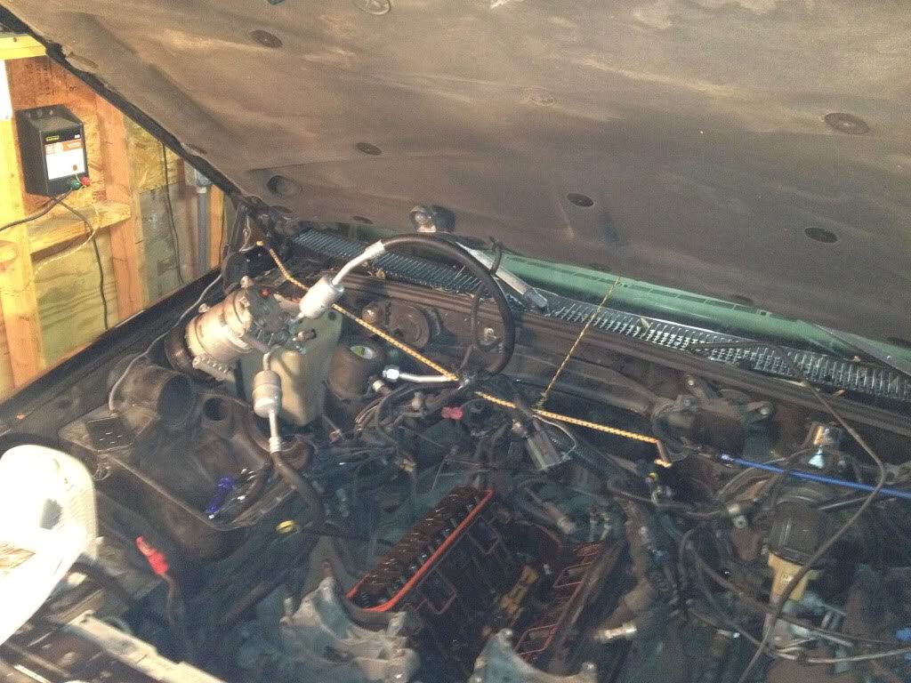

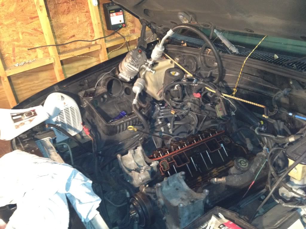

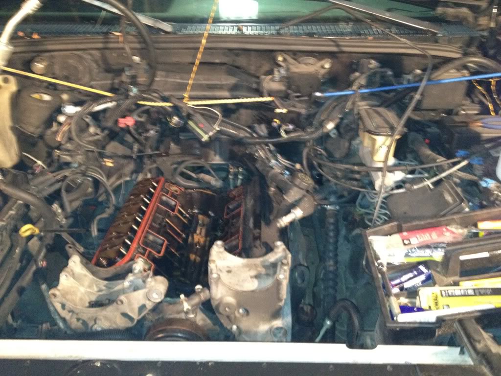

Ok sorry guys it's been a while. My Christmas break ended up being really crazy and I only had time to partially take apart the engine. Now I am back home through Monday evening and I plan on finishing my truck. As of right now it is completely apart and the gasket is broken right where the guide said it would be, so yes it's definitely the lower intake gasket that failed. The whole valve channels and insides are a mess from all the coolant. Lots of cleaning up to do tomorrow. Haha. So basically I am working on my truck all day tomorrow and I have a few questions.
1. What is the best way to clean up the gasket surfaces beyond a razor scraper? Should I buy any solvents or anything? I am going to lowes tomorrow to buy tools so any suggestions are great.
2. I marked the distributor to help realign it, but how do I go about resetting the cam timing when everything is done? The guide said that you can't use a timing light on these trucks and it has to be done with a scanner? Is this something I can do or should I have a shop do this? Also, will the truck be drivable at all without immidiately retiming it?
The new gaskets are felpro also which is nice. One last thing is how long do I have to let the new sealant sit and cure before the truck can be started? Thank you!

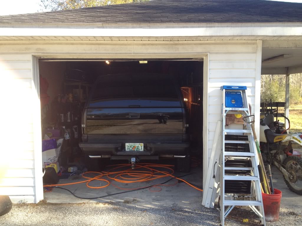

Well none of my questions got answered, but despite you lazy bastards I still got the hoe all put back together and running right :) I spent about 20 hours doing the whole thing in our little tiny ass garage, but it was not problem since I went slow and took a few pictures of the layout. I have never torn into this engine at all, or any other V8 engine for that matter. I learned a ton and I bet I could do it again in less than half the time. I drove up to Tallahassee last night and it was perfect! I honestly think that she runs a little better and smoother now :)
