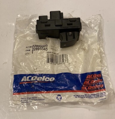

OK. So today, my other kid did not hear a sound next to window motor (w/panel off).
I don’t know if I am doing this right, but I got no light, w/ignition on, trying this pin and the one next to it.
Any other tests I should do before door panel goes back?
I also tested the power on & the RR door switch.
thank you

What year are we working on, or did I miss that? Some of these within the same body style have somewhat different electrical systems.
Have the appropriate fuse(s) been verified as having power going through it?
thank you
It wouldn't light up moving the switch back and forth?
