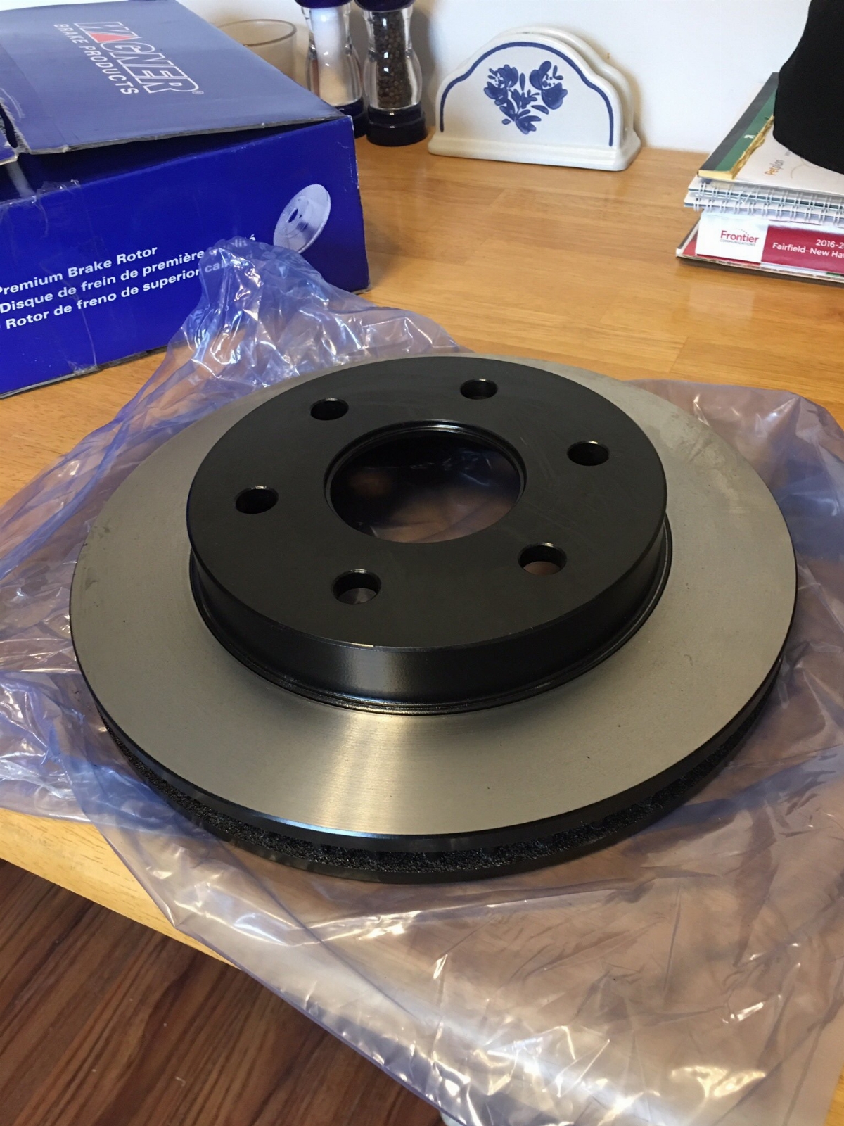

I run Wagner ceramic pads and there premium rotors they paint the areas that typically rust, still look good after a year ba94c17bfdcabfef6b79de29f254befd.jpg

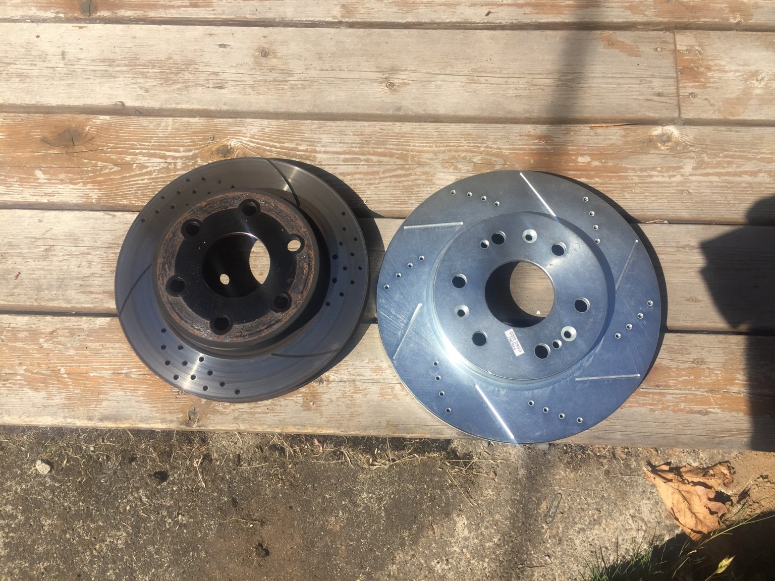

I bought the drilled and slotted ones but if I was to do it again I'd just get the slotted ones. I haven't had any problems and they work great but I've heard for big heavy SUV's the drilled ones can develop cracks. Here's a shot of the difference in size between the 07-14's NNBS and the 00-06's NBS. Funny thing is, our rears are bigger than the 07-14's. This is a great upgrade for very little money.
Link?
