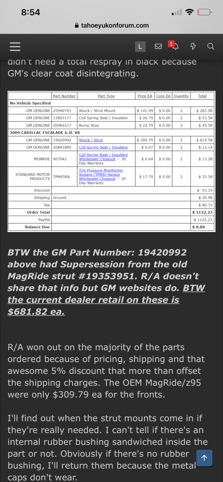

Awesome found them. Took a screenshot to add to cart, do they offer new springs for that strut, or just reuse the original ones. Do they offer a coil over setup so I don’t have to compress spring off and use the old one. And for the rears there is two options. One says adjustable on the info description other one says not. Do u know which part number I would use to match those fronts

You should be replacing all the connected parts. Springs should be ok to reuse. The original springs no longer made and aftermarket do not state any specs so stay clear of generic replacements.
You’ll need a spring compressor once the assembly is out or have a machine shop do it. Here’s all the parts. This is identical to my 09 Escalade that takes z95 inserts. It also shows an option to go with all aluminum front suspension parts.
Post in thread 'Aluminum / XFE NNBS Front Suspension Rebuild'
https://www.tahoeyukonforum.com/thr...-front-suspension-rebuild.146131/post-1853541
Both of the rear z55 part #’s will work. May as well as use the higher part # because it’s the latest version. No coil over set up offered unless you go to overseas made junk or off road capable which will give u a bounce house.
All rear z55 are air adjustable for ride height via the compressor controlled via height sensors in the suspension. The front is active like the rear but not height adjustable.
Again you have all the same parts as my 09 Escalade except yours has z55 strut inserts. Use that link above to order all the parts from R/A attached to your strut. Don’t forget the 5% off coupon for R\A

Ok will do. I will order everything off your invoice. I really appreciate your time and effort in helping be get the correct suspension. I always try and research and find it all my self but this Yukon is difficult and so many different things to throw at it. So everything on this invoice I order except change the inserts to z55 insertsIMG_6500.png

Correct, z55 strut insets. There may be 2 TPMS sensors in that list, so don’t order those :)
Down the road you’ll have the option for replacing all your suspension bushings for the price of new aluminum replacement parts. It shaves about 50-60lb off each front wheels.
We sold our 08 XL Denali after all the z55 was replaced. Amazing ride. Was going to do Arnott on our current 09 Escalade. Glad I waited since GM pony’d up for the lifetime guarantee and Arnott dumped theirs.
