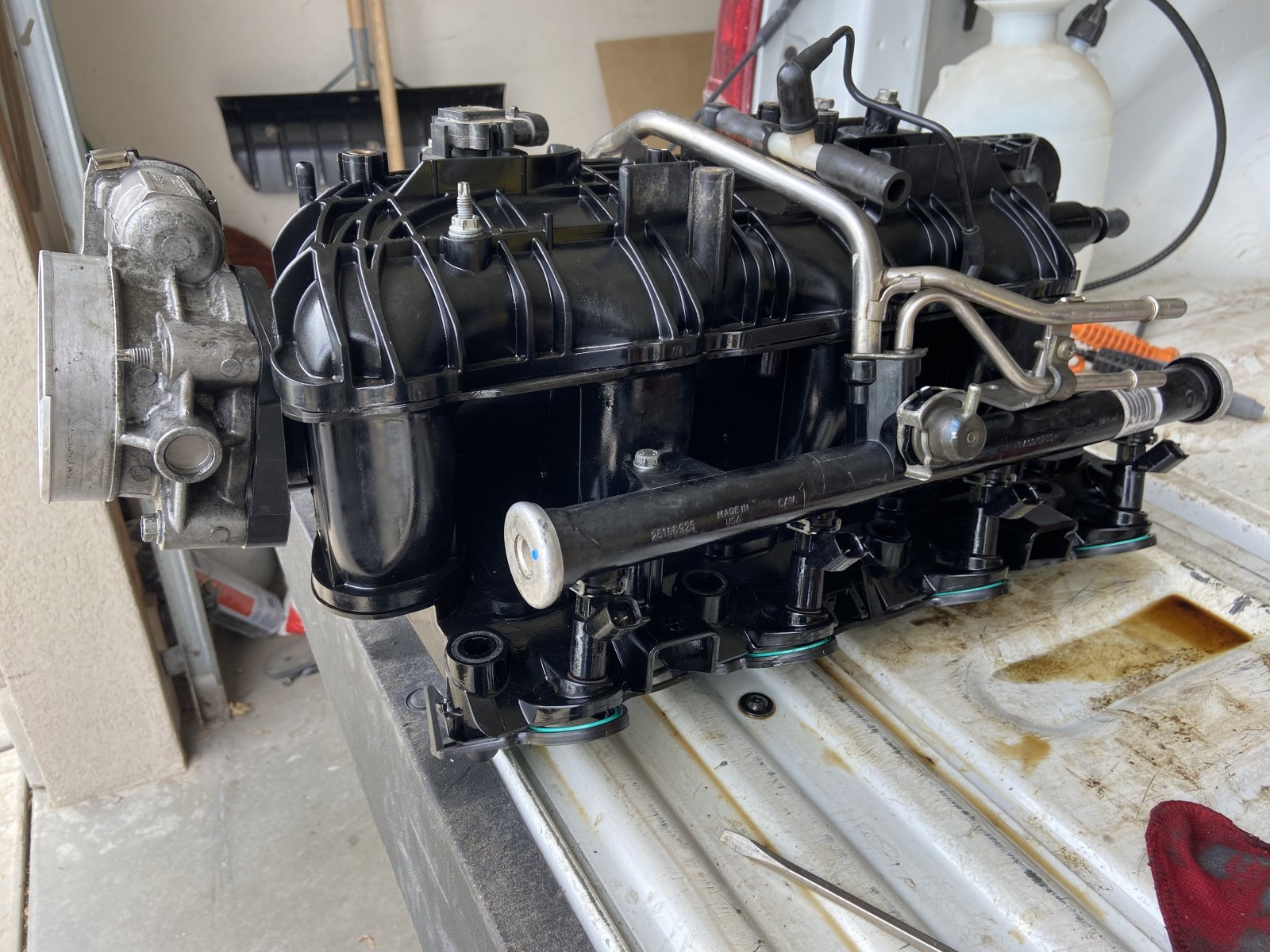

What fuel rail did you find?
A GM 12621662 fuel rail.
Update: If you want to use the fuel injectors (OEM 2002 Tahoe Flex Fuel - my Tahoe) which I do, then this is the wrong fuel rail. The correct fuel rail for my application is 12660709. I received the fuel rail today and verified the fit with a spare flex fuel injector I had on hand.​

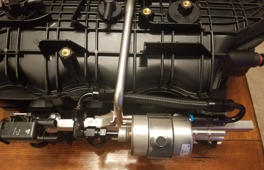

I assume that you are going to run the Corvette fuel filter to merge into your return fuel system? It is a shame that GM 88894358 fuel rail is discontinued, it fits over the newer intake when using the larger Flex Fuel injectors.
Right now that is the plan, but I'm still looking at other options.

So on Tuesday the fuel rail I ordered (12621662) was delivered. It did not work. After deeper research I found the correct fuel rail. If you want to use the fuel injectors (OEM 2002 Tahoe Flex Fuel - my Tahoe) which I do, then this is the wrong fuel rail. The correct fuel rail for my application is 12660709. It was delivered today and I verified the fit with a spare flex fuel injector I had on hand.
