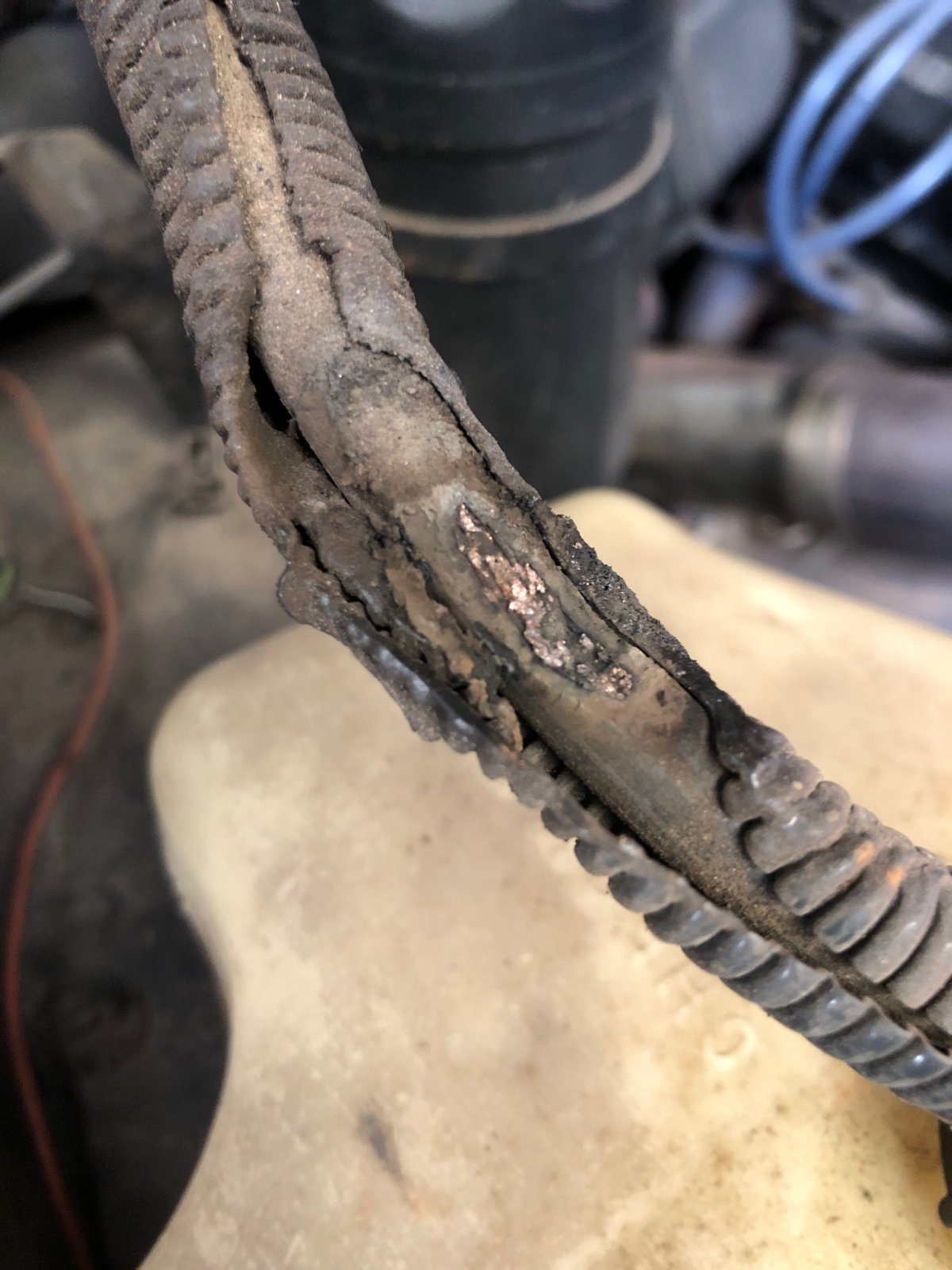

Good job buddy. Now don’t forget it or it will come back to bite you in the ass. Order that new plug.Just giving an update to my code P0200:
Turned out to be a broken wire injector on #1 cylinder. Took me awhile to find it, as it broken right in the curve of the wire where it went into the plug.View attachment 223531 Didn't have time to look for another plug in the parts store, so I used a jumper wire.View attachment 223532
Of course I couldn't find my shrink wrap--yes I do have some--so I just taped it up really good. Took it for a test drive and it chirps 2nd gear again--NICE!! Runs like a champ again.
I know--gotta go to the parts store and see what Dorman has available. ThxGood job buddy. Now don’t forget it or it will come back to bite you in the ass. Order that new plug.
