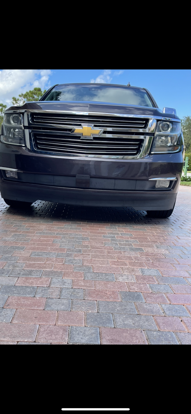

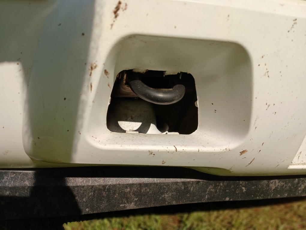

I installed 2 hooks and the plastic piece with the cutouts, all oem parts too.
Thank you for the picture. It looks nice. Looking at the factory options list, they did show the tow hooks as optional, so there must have been a bumper panel to allow for that.
I like that there seems to be a surround on the hook itself to help stop the high pressure salt water injection of winter driving.
I do have adaptive cruise, so I need to get my head under there and see if the sensors would be compromised.
Thank you everyone for your replies

I don't think so unless they made a custom cutout.

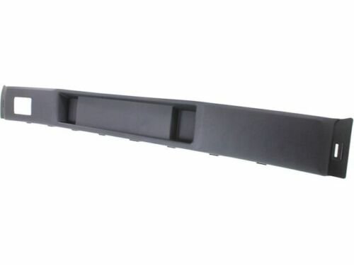

Blaine is correct, you can order the panel with 1 or 2 cutouts to suit your application. I added the 2 front hooks and factory panel on my 2020 SLT.

The problem is - that rare panel you can order with 1 passenger side cutout, does NOT have the cutout recessed, which must make use of the factory tow hook an even worse experience! At least that is what I have seen when viewing the picture of the panel online. I have never seen one in person.

There is a gap around the tow hooks. I thought I saw some sort of a rubberized type of "filler" on some trucks but I don't have them. It is just an open hole, and I have not been able to find a part number if such a filler exists.
