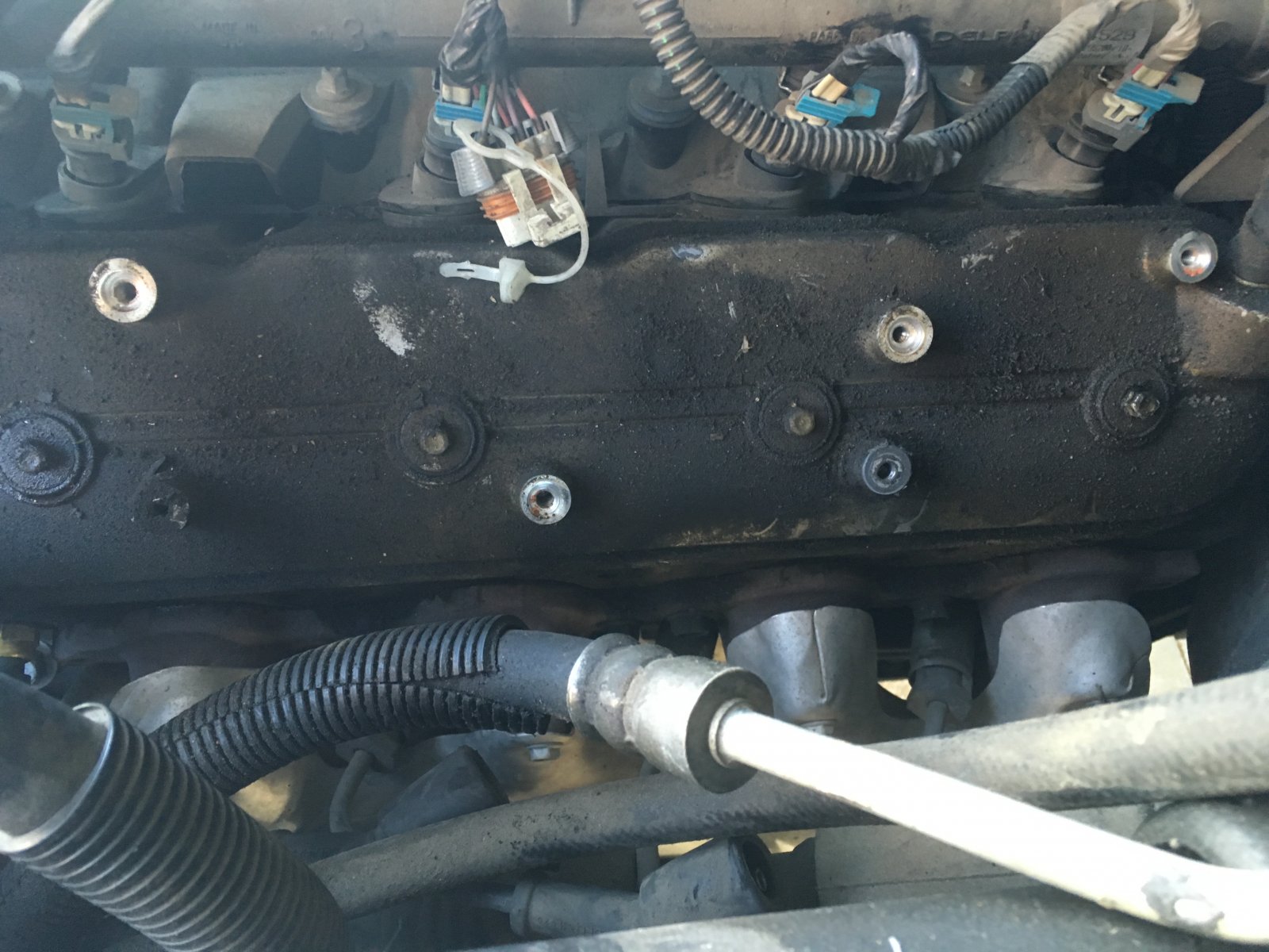

The passenger side looks like a lot of trouble with all the extra stuff that needs to be pulled out of the way. I changed the drivers side valve cover on my 09 Tahoe Hybrid right after I bought it a few months back with 195k miles on it. Even with mine being lifted 3.5" the drivers side is open and easily accessible. The reason that I changed mine was that I was not sure if the existing valve cover had ever been swapped to the updated PCV design. I bought an updated one at Advance Auto parts (w/gasket and grommets) for less than 50 bucks. I have attached a couple of pics. Previous owner looks to have neglected the oil change intervals on mine as I do have light sludge buildup. Currently at 204k miles and it is running good and holding good oil pressure. Fingers crossed that it runs to 300k as planned without any significant issues.
