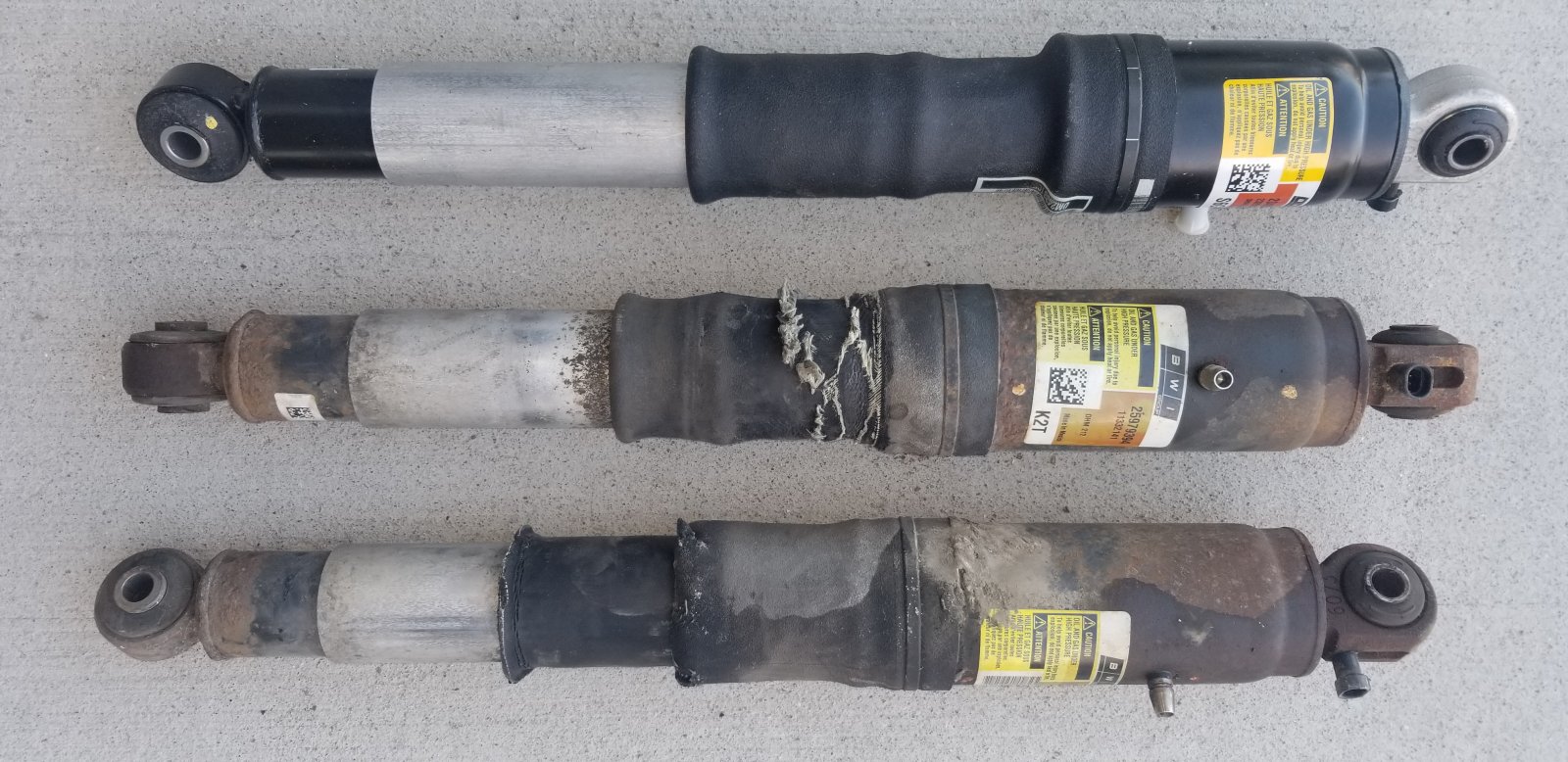

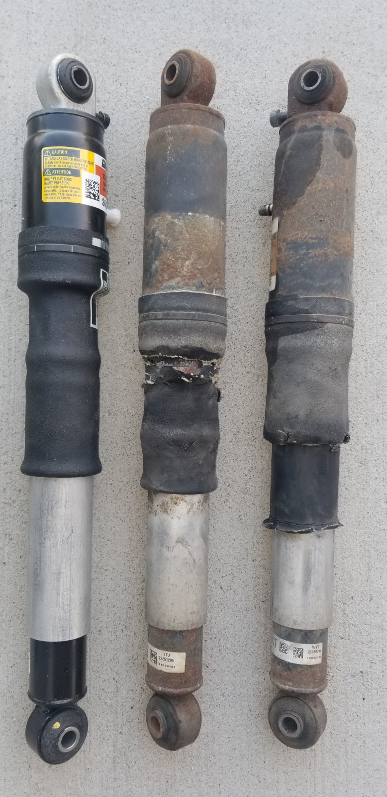

Should I also replace the airlines? I've read mixed reviews on the Dorman - should I go OEM?
I left my factory air lines in place as they were. No problems. Your choice on Dorman vs OEM. When I did mine I researched the Dorman and at that time people were having good experiences with it. In my own experience, it's a quality part that's held up great in the 3 years since I replaced it.

Does this look right if I go OEM? I still have to think this through, but there was a lot of lean when we had all of our stuff back there.
They talk about a shock absorber nut tool - do I need one?
And you guys feel like someone like me (a non- car guy) can do this?

Yes. 5801095 is the part number I installed on my 2012 exactly 3 years ago:
