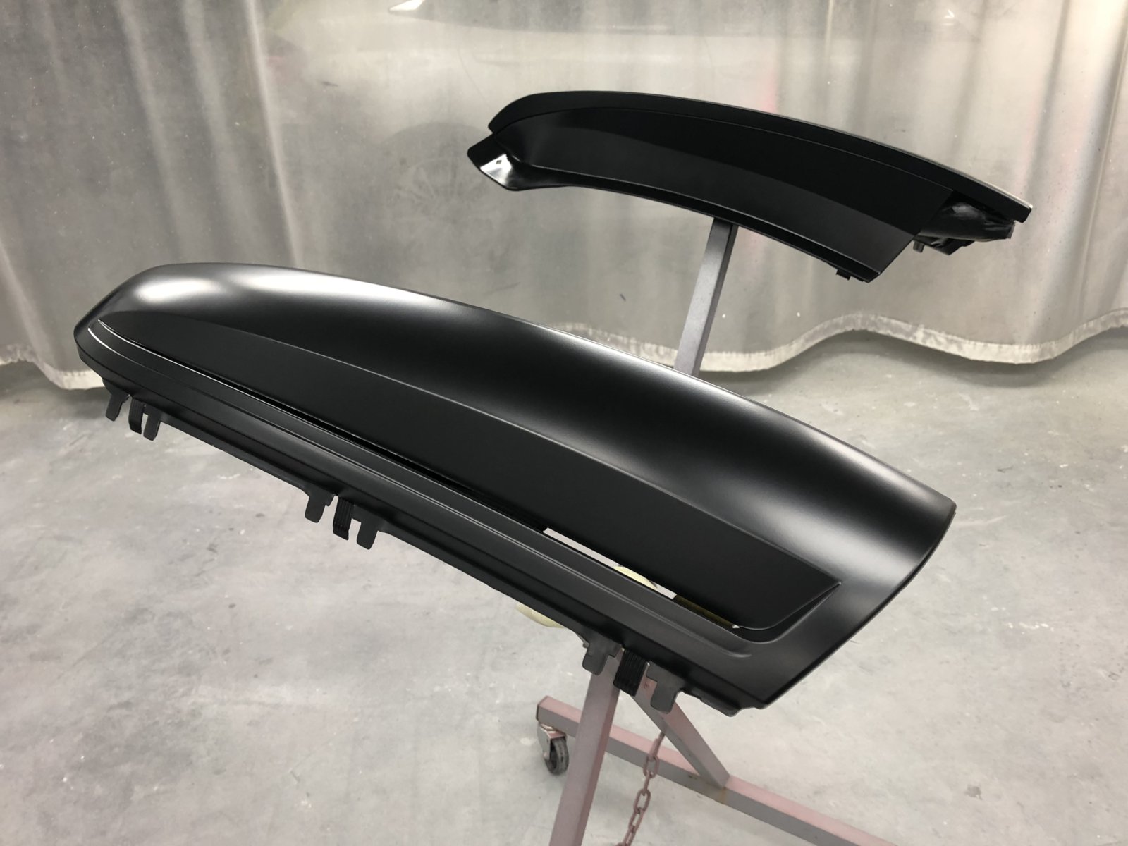

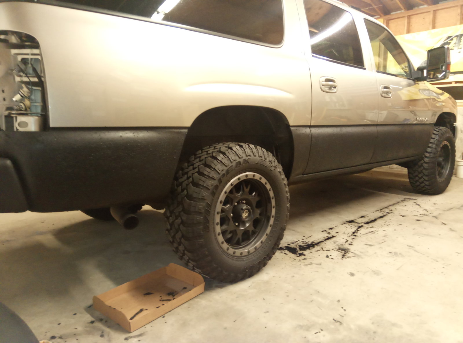

Oh man it's crazy hot these days, I think Monday I'm going going to pull my bumpers off and prep them for bedliner, then Tuesday after I drop the Tahoe off, I'm going to spray them.
Then when I get the truck back I'm going to tape off the fender flares, prep them and spray them too. I'm thinking of spraying the door molding as well to finish de chroming
I'm going for a white and black theme

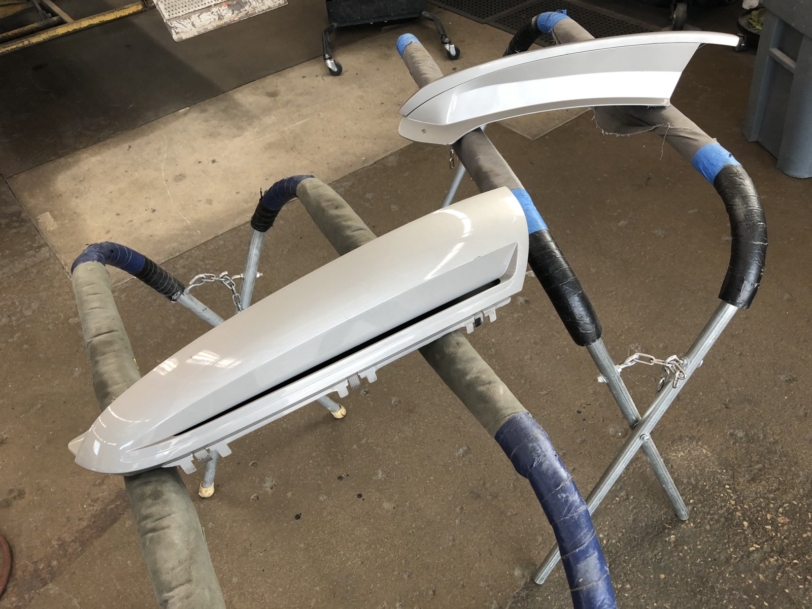

What details do you need? Maybe the following will help.
How difficult was it getting the top dash off?
What color? What product are you using?
This was my second time removing the top dash so it was a bit easier, but I would say it took me 15-20 minutes. The glove box took 10 minutes because there were 2 rivets. I didn't remove the airbag, doing it in place. Same for the part that's around the glovebox area- it looks like the console would have to come out, so I pulled the right side loose and propped it away from the airbag and prepped it. I just finished painting those 2 parts. So 30 minutes or so removing everything that I'm painting. I'm using SEM *** Adhesion Promoter and SEM 17163 Med Dark Pewter for my Pewter dash. It's almost an exact match but I think mine is faded or it would be perfect, that's why I'm painting everything that touches the top dash.
