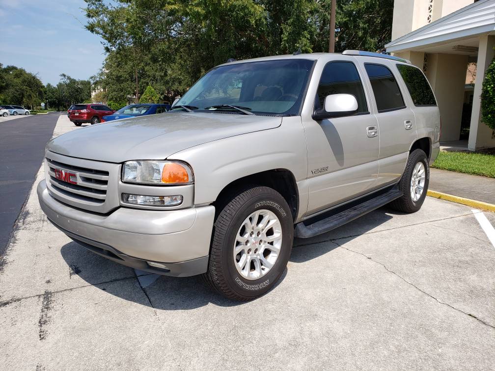

After months searching and scouring the web for reviews and opinions on the best Z55 Autoride replacement, I finally installed my Arnott AS-2700 rear air shocks (Arnott), front Bilstein 4600 (eshocks.com) , $15 eBay resistors and Dorman air pump 949-000 (Amazon) Yesterday. For only $600. Plus I get back $50 from Arnott for my old rear Delphi shocks. So that's about $550.
WOW, it rides amazing!!!! Flat and level in the corners and irregularities, smooth, not harsh, not firm, not too soft. No more sea-sickness from the ride like being on choppy waters at sea. No More nose dives with quick stops. These shocks are a perfect match for eachother. Pump only ran for maybe 2 seconds to air up the shocks on initial start-up, mine did not sag much in the rear, just a little. They still have air as of this morning. Bolts came out with ease, even though the shocks and pump were original at 219k miles. Everything was plug and play, except for wiring the front resistors. Surprisingly I never had a check suspension light on even though the fuse was good, front right Yaw sensor arm was busted and GM pump never worked.
I highly recommend this option for those wondering about replacing or deleting their old Z55 Autoride.
This is the best riding vehicle I have owned. I couldn't be happier.
