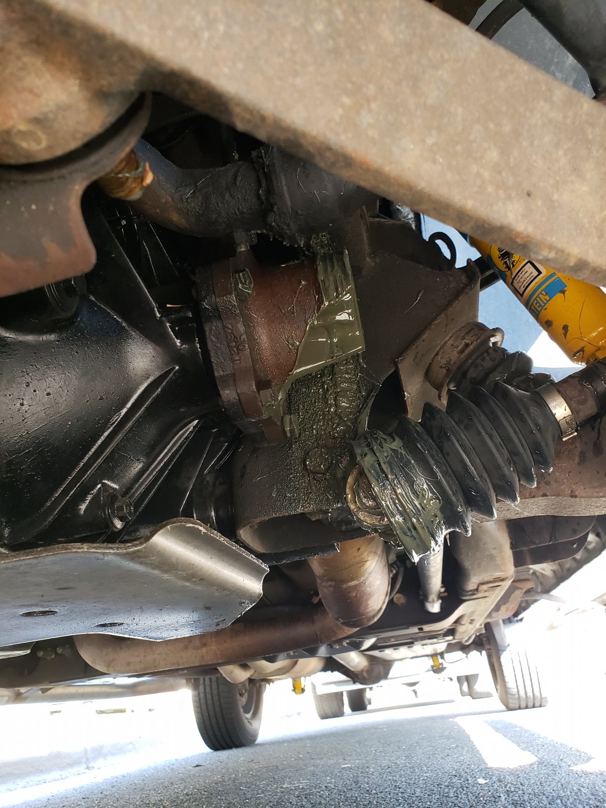

Also hoping to get both front axles swapped out while motor is out. Both are slinging grease from loose boot ends. Not torn, just loose where the metal bands are.
