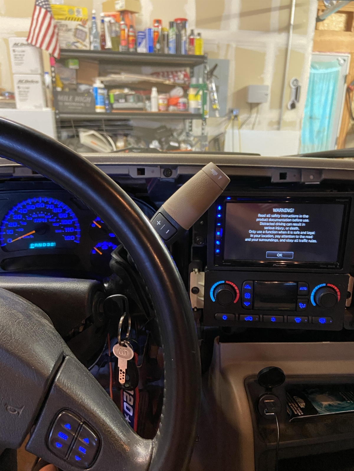

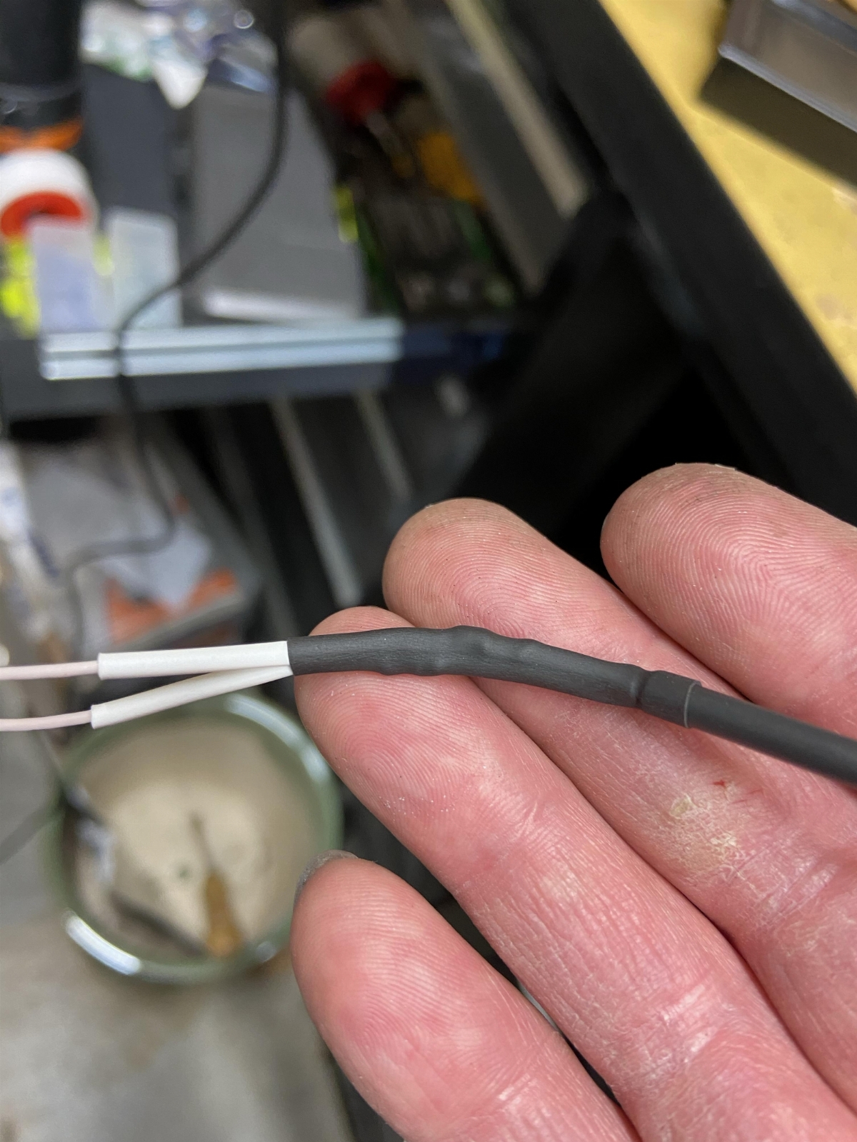

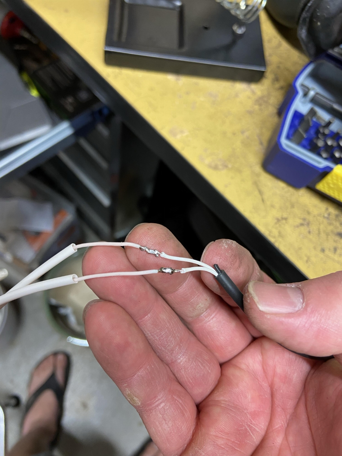

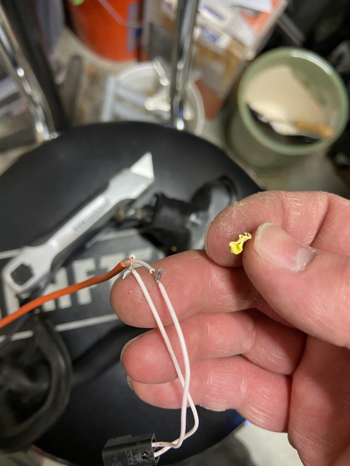

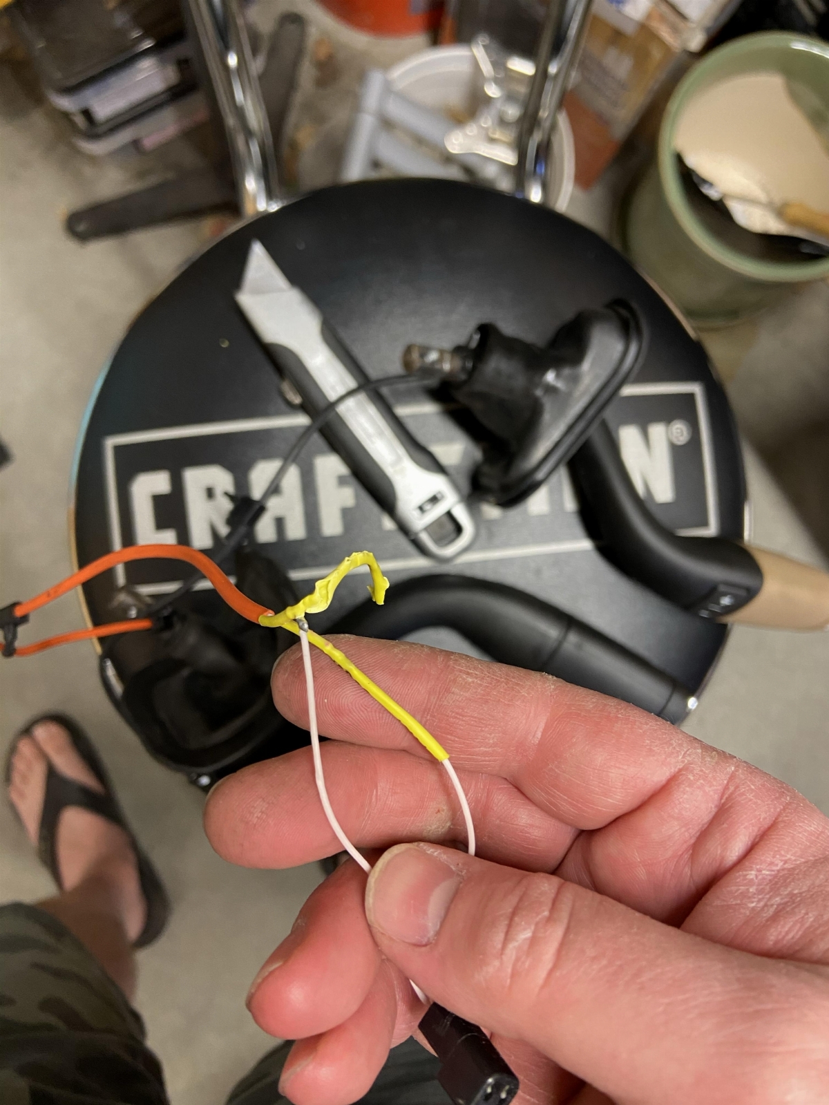

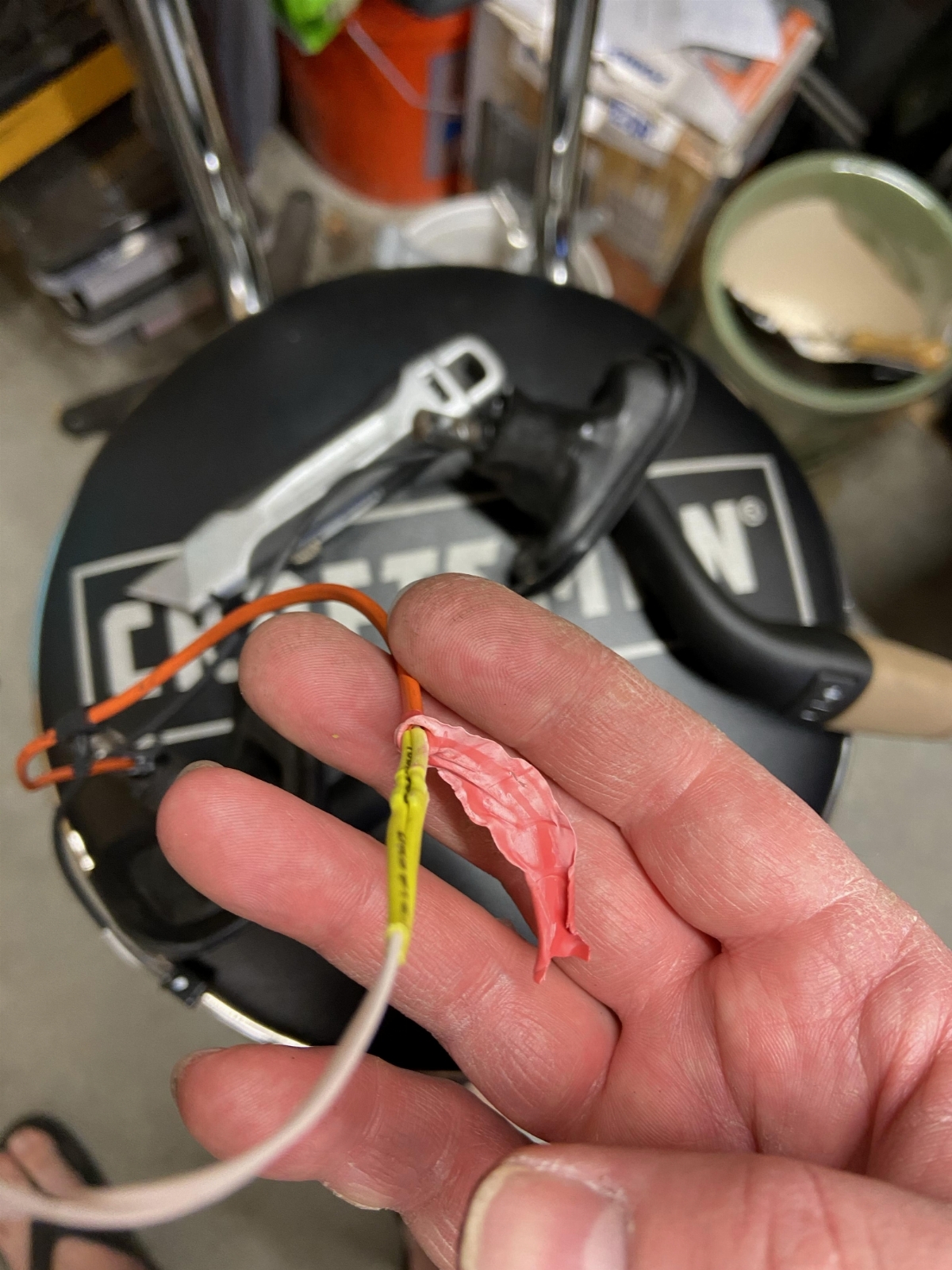

I bought one of the bypass kits off amazon, for 10 dollars, it was an easy install, and never have to worry about the Parking Brake sensor
My bypass kit.
It's the braided green wire. Parking brake wire to ground wire. Wired to an on/off switch. Works great.

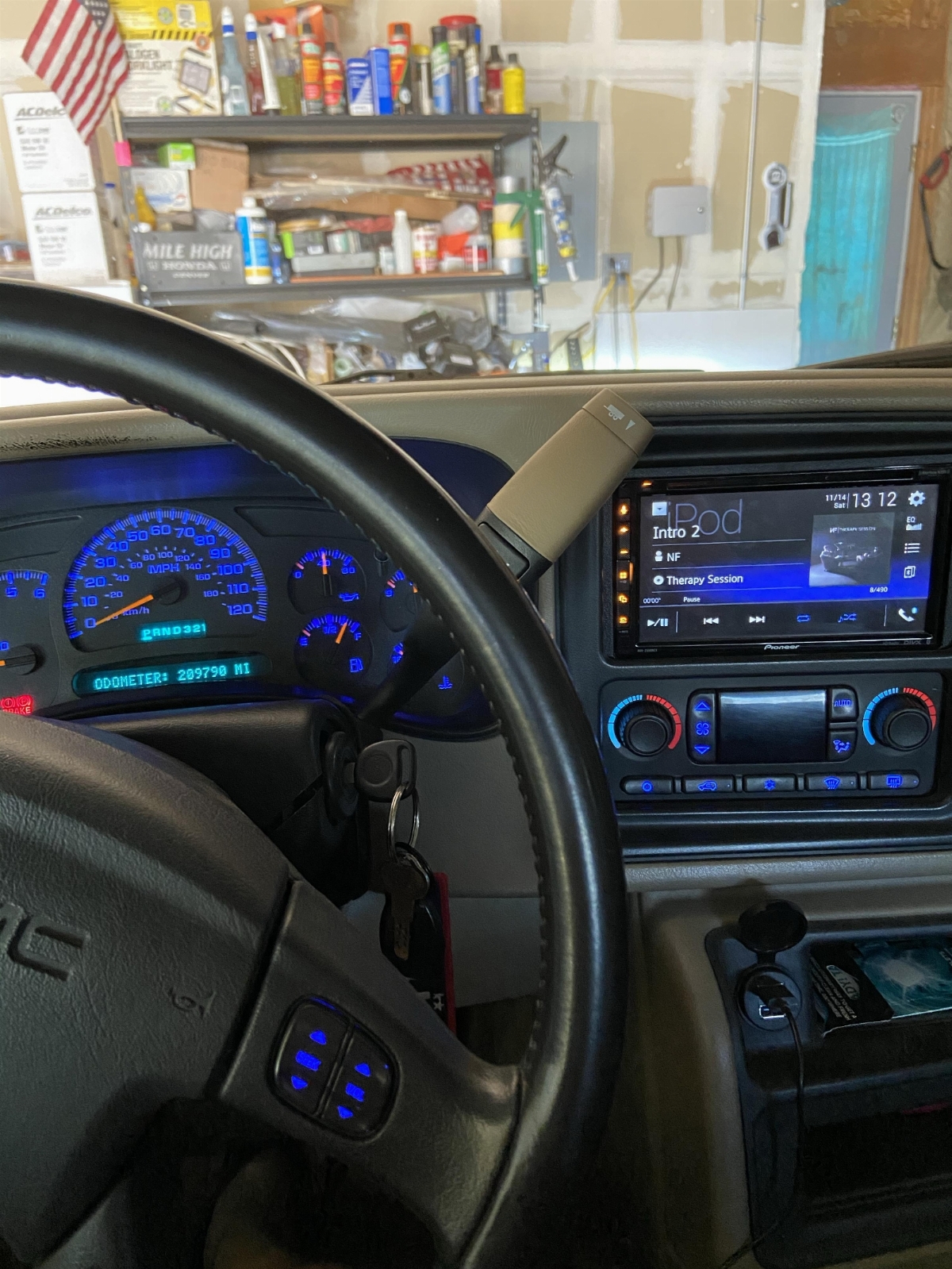

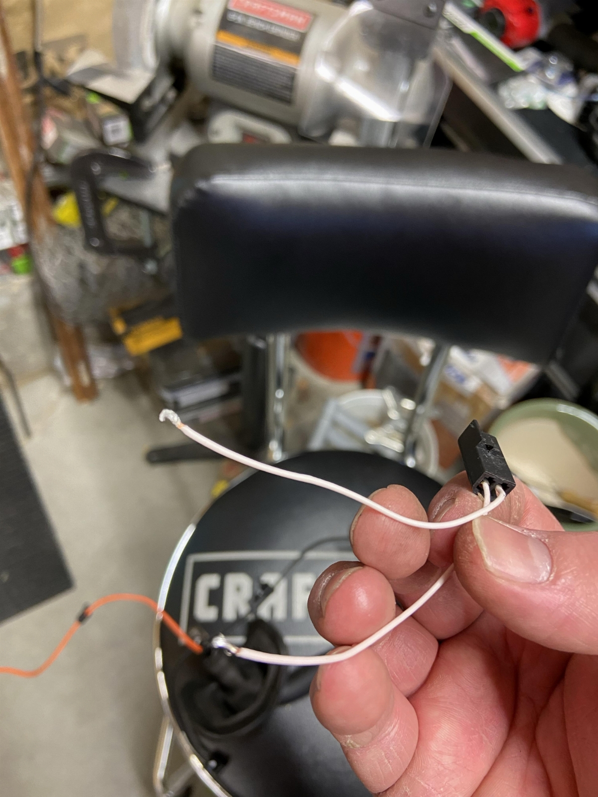

I wonder if it's just a fancy version of what I did.
Lazy man's version , no manual on/off switch. It's a relay that switches itself on/off/on to send the signal back.

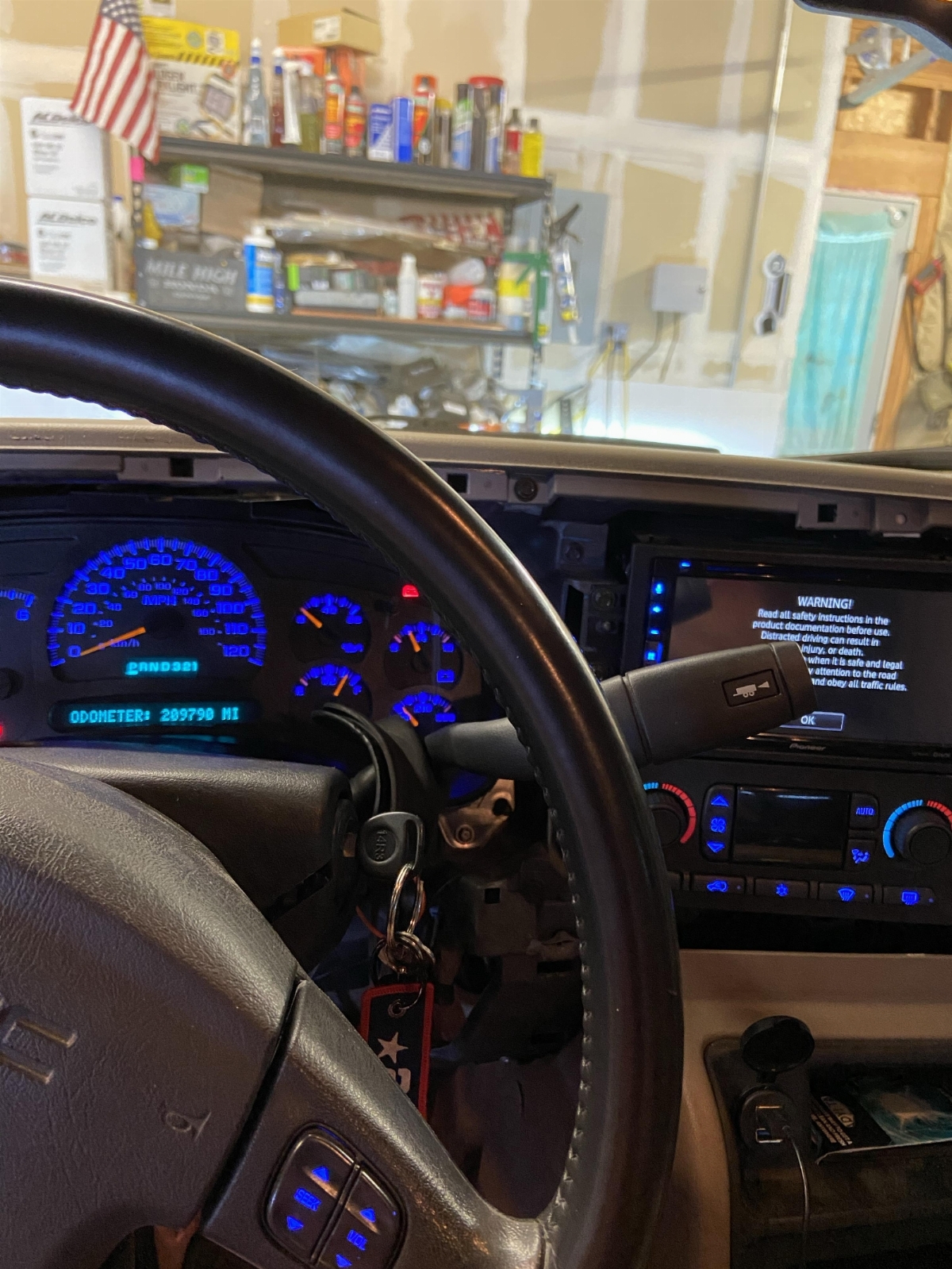

Im trying to figure out my rear view camera too.
05Single
afraid of the dark
Feb 26, 2015
8,186
11,456

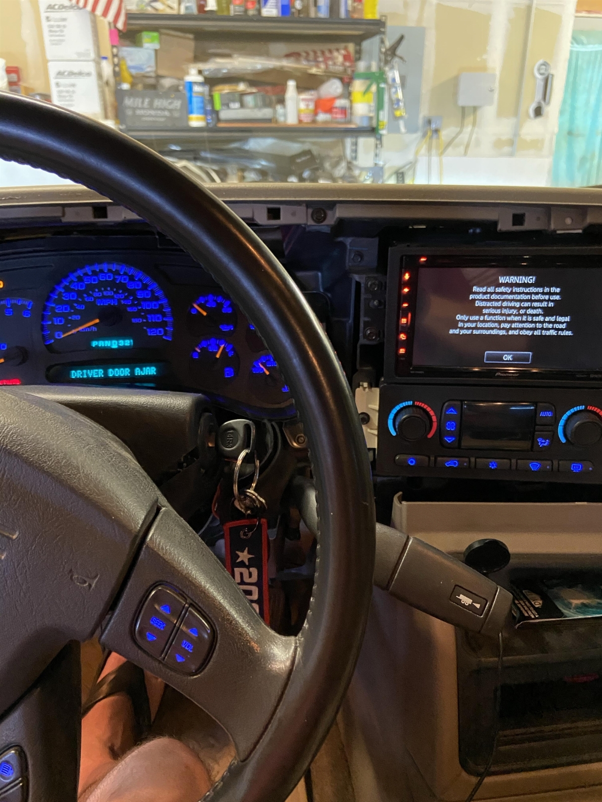

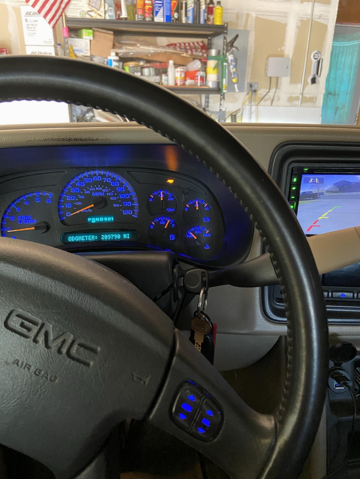

This is what I got @Tonyrodz
Mount the camera and run the wire to the main harness. From there run the red and black to the reverse light. From there run the rest of the cable to the deck. Plug in the yellow rca to the AV/in ......and I guess the red wire coming off the rca splices into the reverse trigger wire on the back of the deck?
I know it's simple but I feel dumb, it's my first camera install and Mr ebay never sends instructions for anything lol.
