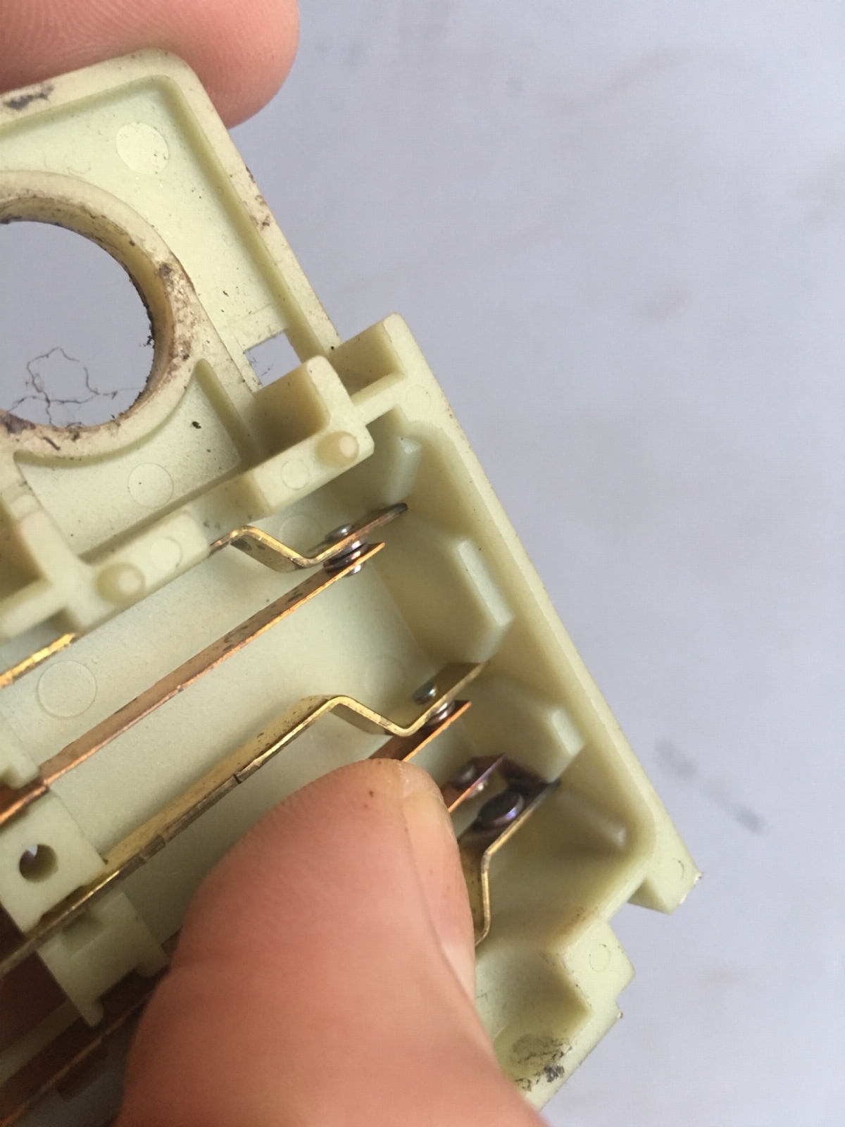

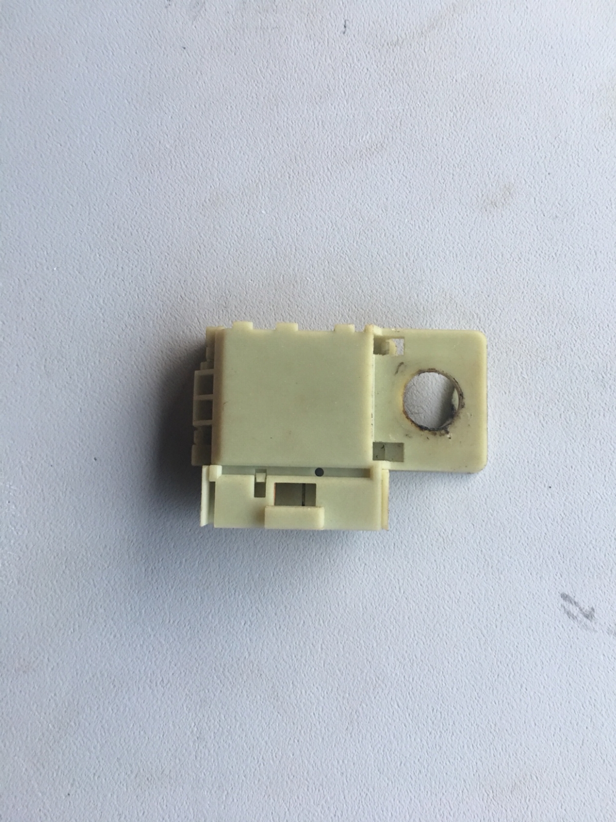

Coming home from work today this kid in a nice old late 70’s Chevy pickup is trying to get my attention at the stoplight, so I roll down the window he mentions that he didn’t see my brake lights come on when I stopped, so I get home and check them and yup they are out, I checked some fuses they were all good so I pulled the brake light switch and it’s bad so ordered an AC Delco off Amazon should have the Escalade back on the road Thursday night, with the adjustable pedals it’s a pain to get at.
