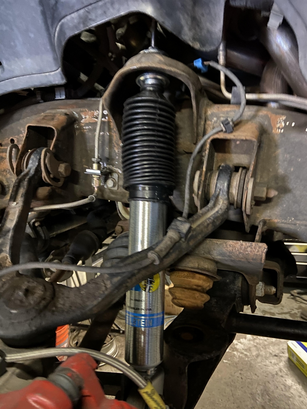

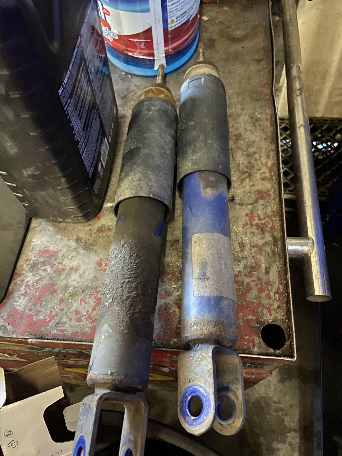

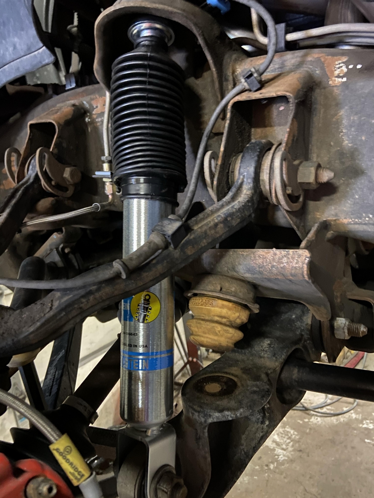

Yesterday, got my Bilstein 5100’s in the front, and replaced the upper control arm, and lower ball joint on the PS.
She rides sooo much better. These were the original shocks up front I believe. They were definitely shot. Much tighter, and she settles immediately after road bumps and humps. Even silly things like drinking from my water bottle while rolling are vastly improved. Not spilling all over myself anymore. Lol.

How hard was replacing the ball joint?
Couldn’t have been easier for me. My buddy had a heck of a time with the control arm though, due to the torsion bars. Have to lower down to ease the pressure on it, so you can line up the 3 bolts.
