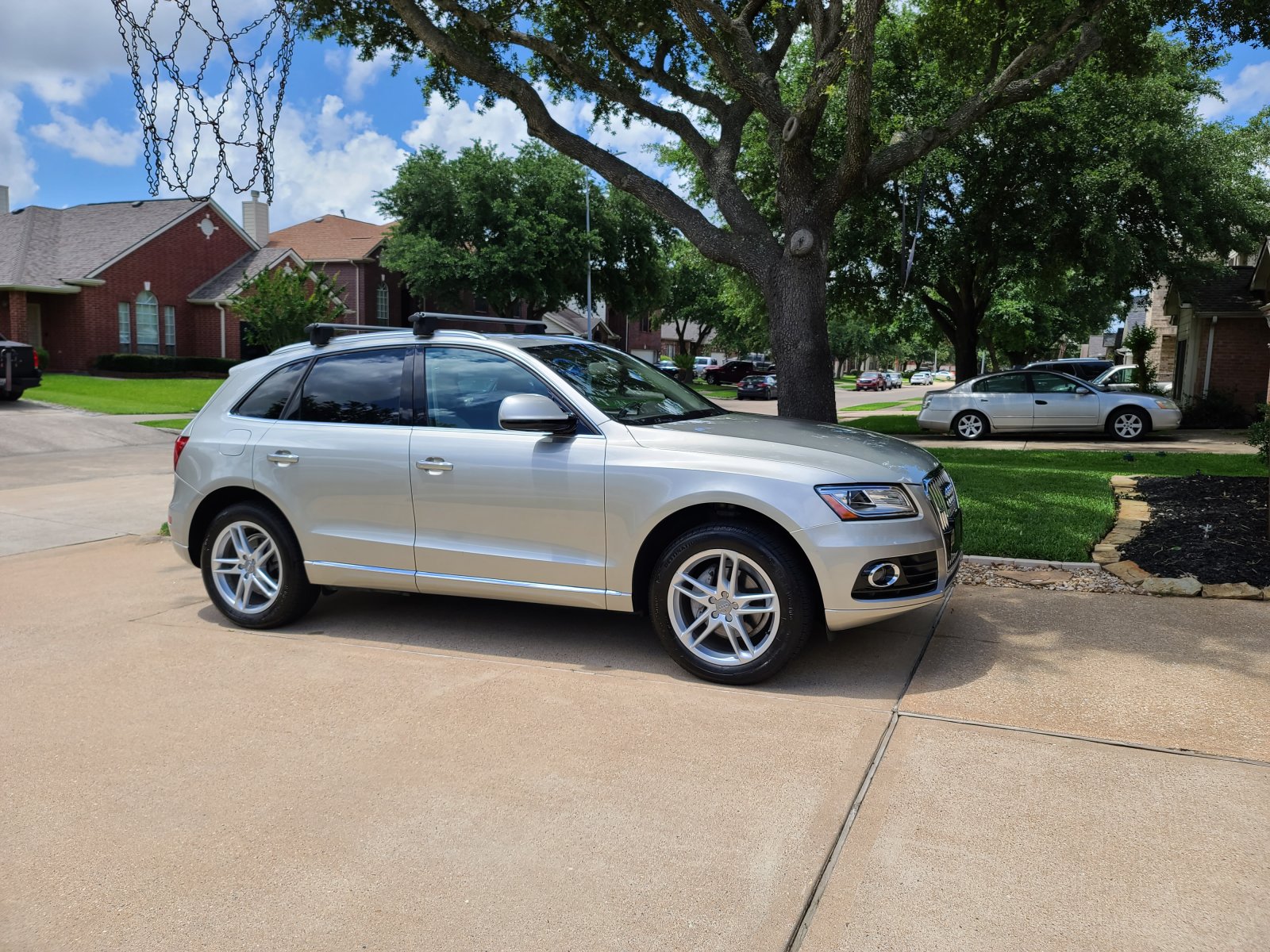

I picked this thing up for work a few weeks ago. Been keeping me busy and my mod money tied up! Love the 2.0Turbo in it. Probably going to park it and drive the tahoe anyways. I dont like the miles climbing up closer to 27K. Tahoe cluster is broken so what I can't see can't hurt me or don't exist!! I just pretend she doesn't have well over 240k miles. She still my baby!! I need to post up pictures of my shorties. Looks good in the bays.
