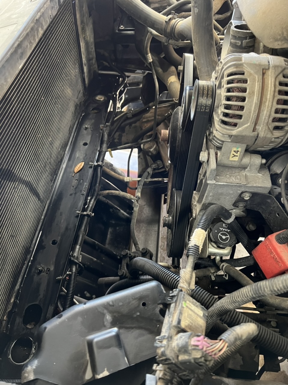

Suburban decided to puke its guts out on the freeway. Limped it home. I’m in the middle of replacing coolant, radiator, quick connect on the heater core. Got the radiator from vatozone I did verify radiator comes with the restriction on the right tank. Have great heat up front not so much in the back. May have to empty it out and burp it via the top radiator instead of the overflow tank.

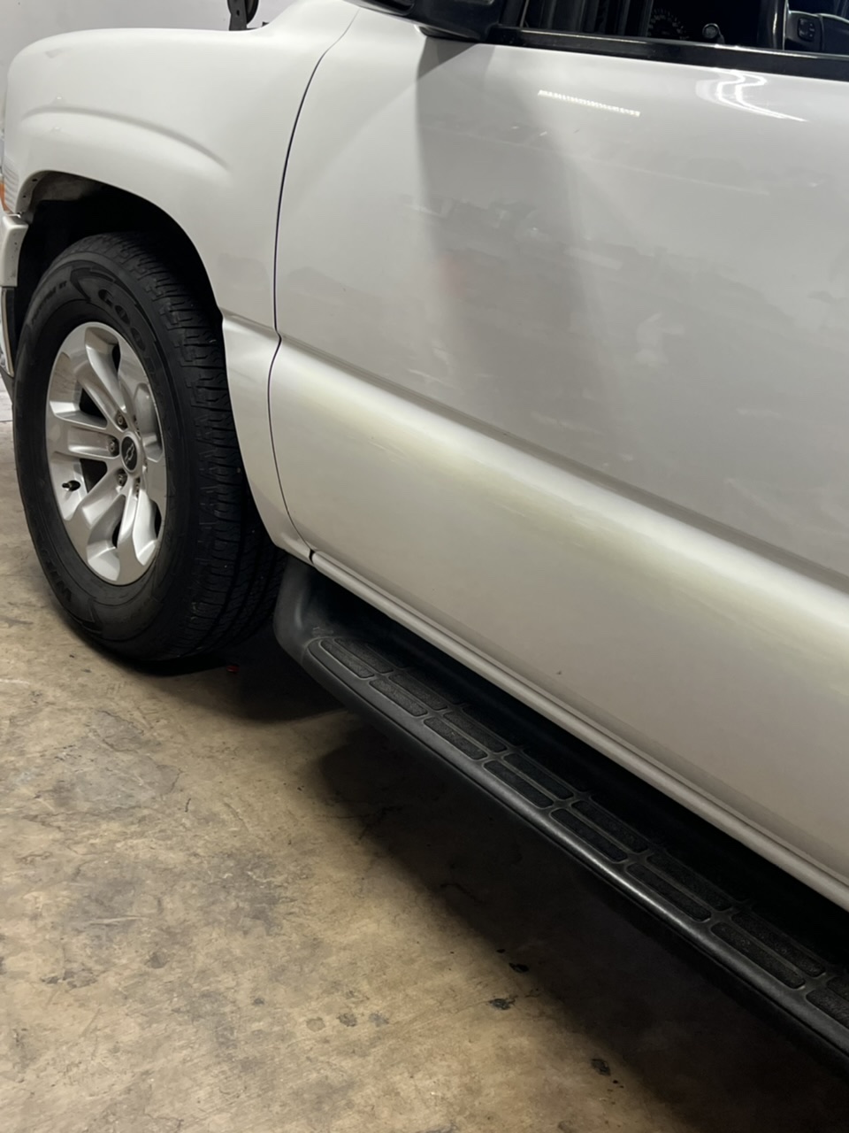

Removed the door mouldings and the 3m tape left yellow staining I have not been able to remove. Should have left them on. :banghead:

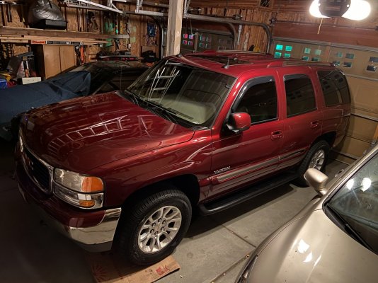

Yesterday, overnight, we got absolutely hammered with snow. A whopping .3”…. So taking my kiddo to school in the am, got Lucy all disgusting and dirty.. so gave her a quick wash that afternoon… :rockit:

Make sure to use an OEM t connector, the Dorman ones fail quickly. Some buffing compound and a good buffer should remove the yellow.
