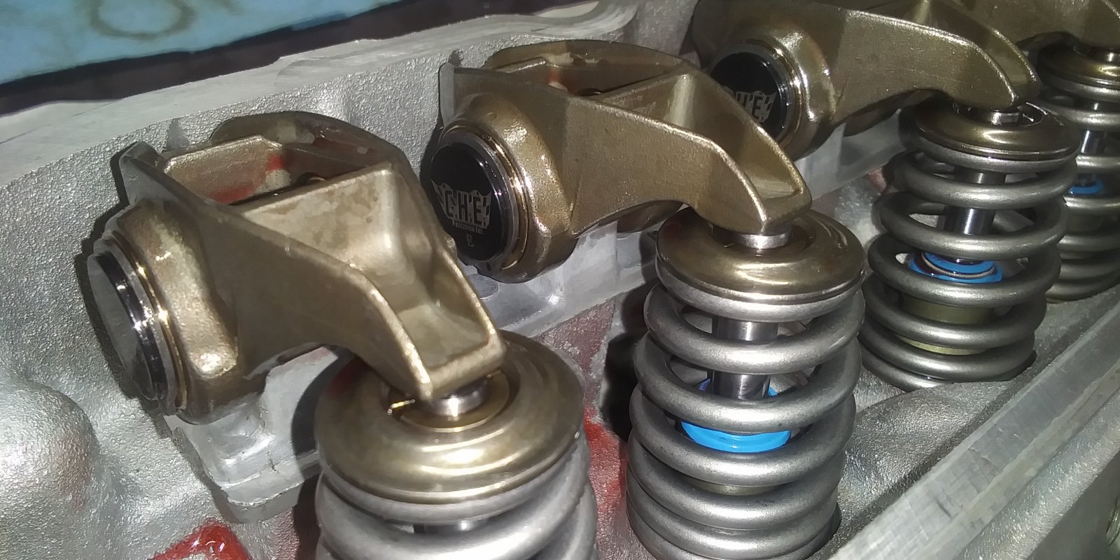

Ouch. But, you might could have a cheap builder set to mess around with and swap on some day, should you ever feel so inclined.
I gave up on cleaning these rockers and putting the trunions back in.
I first read this as you putting the stock trunnions and bearings back in. lol
The valvetrain is the worst part of building an engine if you like instant gratification or get bored easily. Whatever you do, you gotta repeat it fifteen more times. That's starting from the beginning and ending at the same point fifteen times. You're not looking for improvement and certainly not anything worse. You're looking for continuity- The same shit, fifteen more times.

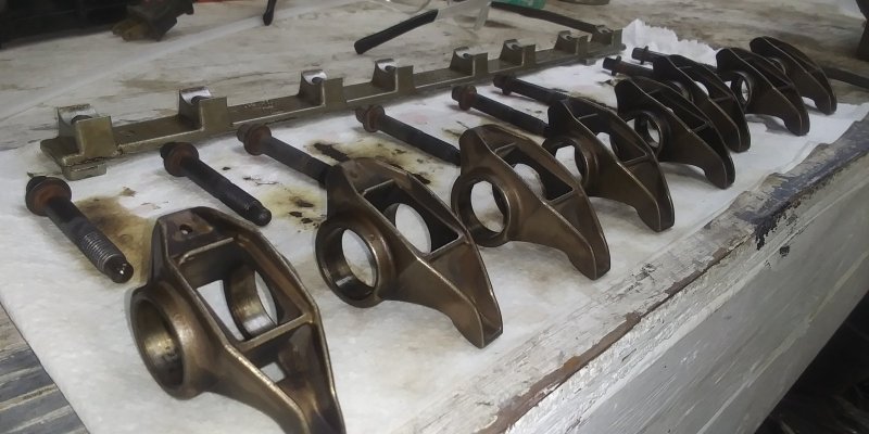

I can't even imagine trying to put these needle bearings back together,
I found some questionable spots while sanding the inner part of the rocker arms. Had to use three from the extra parts, so I basically got my 50 bucks worth out of them already. Wish I would have found it before I cleaned all of them...

It's hard to tell which side of the snap ring is the smooth side, I think I got them right though.
They might have changed up the way they're stamped out to minimize the sharp edge. I'd just lightly drag my finger across each edge at a 45° angle to try to feel which is the smoothest.
Now I have to do the other head, lol
Only gotta repeat yourself eight more times!

I gotta clean the other head a little more, and clean and lap 8 valves, and clean and press put at least 8 rockers too, lol. I might wait till tomorrow, I'm trying to clean up all the bolts and organize them better now
