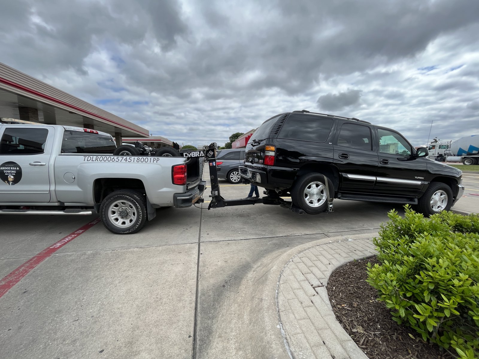

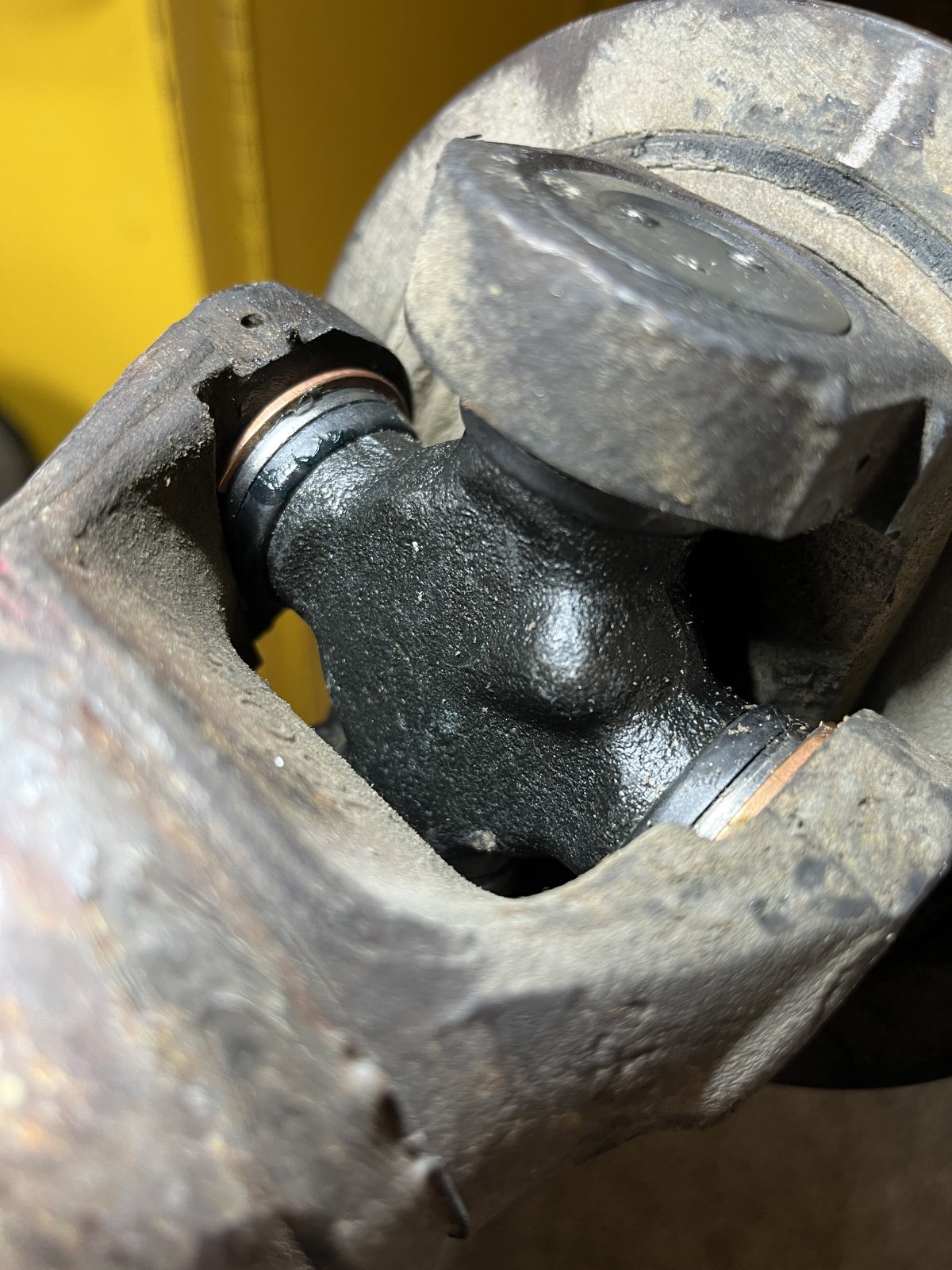

Well, she had to be towed for the first time in her life today. I lost a drive shaft u joint cap at 75mph. I heard a “BAM” followed by a ton of shaking. Thankfully a new u joint fixed her right up and no lasting damage from the vibration is apparent after an 80mph test drive.

Amazing how much that tiny amount of weight can make things vibrate and shake when it flies off!
If I’m being completely honest, I replaced my factory U joints in October 2020 and at the time I remember one of the caps not going on smoothly. I probably caused this myself by not taking the time to make sure it was 100% correct at the time. Oh well, to err is human, I suppose.
