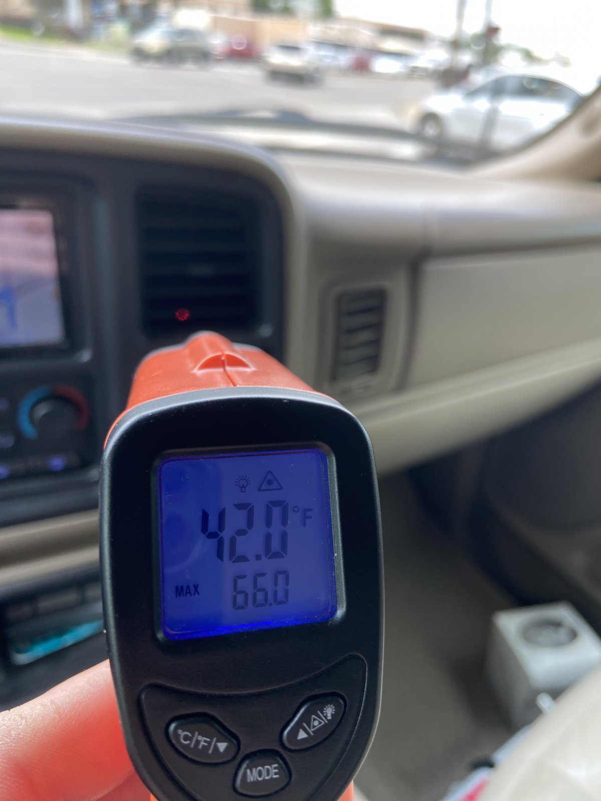

Just picked up the kiddo from school.
Ambient Temperature: 78°
Relative Humidity: 70%
I read between 49 starting the drive from a parked idle (in garage), to a low while cruising of 40.6, but wasn’t able to get a picture while driving. Lol
Around 41-43 while idling at a stoplight:
I wish my home A/C worked that well! It’s around 49 at about a mid-house vent.
