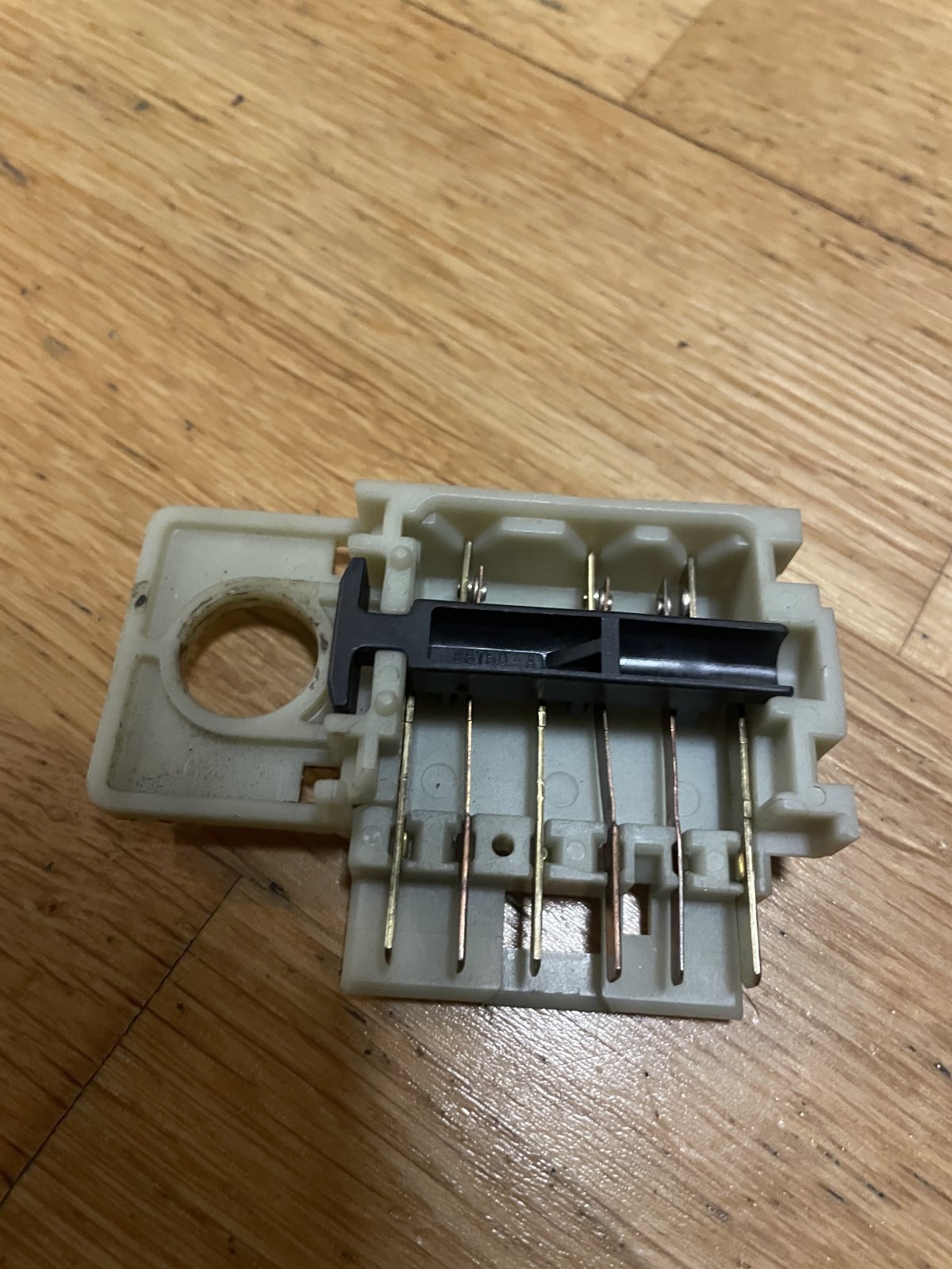

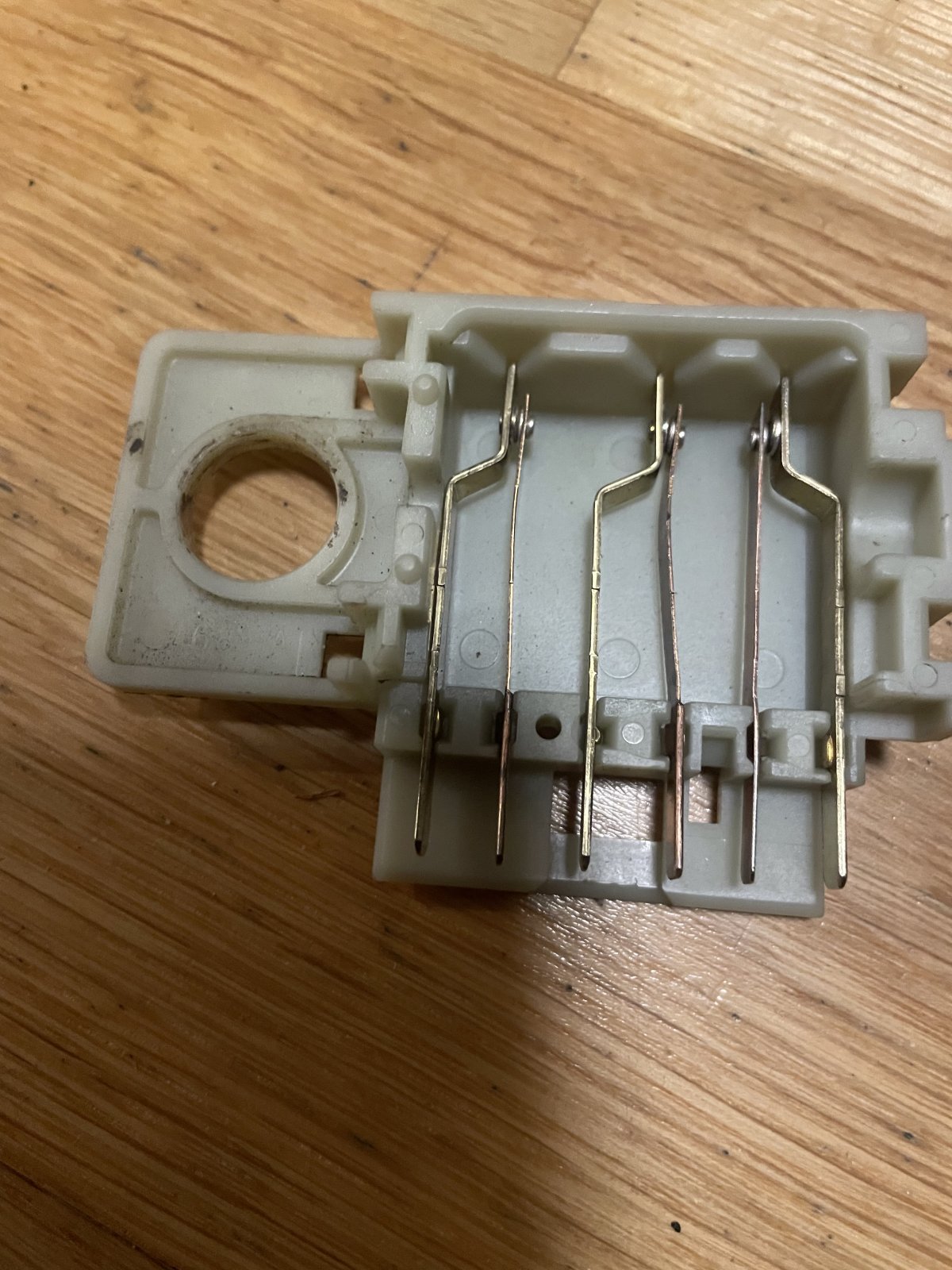

Fixed the brake light switch. This one does not have a spring, the contacts act like a spring, and it had become weak. Bent a little bit and checked that I had one N/O contact and two N/C contacts. Cleaned up with a dremel with a wire wheel (overkill, use sandpaper)
When I went to install it again, one of the wires were broken in the contact, tried to soder it, no luck so ordered a new one (ACDelco PT2362)0E87E691-56B5-4E9C-8D62-640EA95BE340.jpegE608F719-CF32-49A4-929B-141F1A33AC73.jpeg
When I went to install it again, one of the wires were broken in the contact, tried to soder it, no luck so ordered a new one (ACDelco PT2362)View attachment 407391View attachment 407392
I think just about anyone that understands how a simple switch works always tries to "fix" these things yet there's always something that makes them end up replacing it. You gave it the ol' college try.
