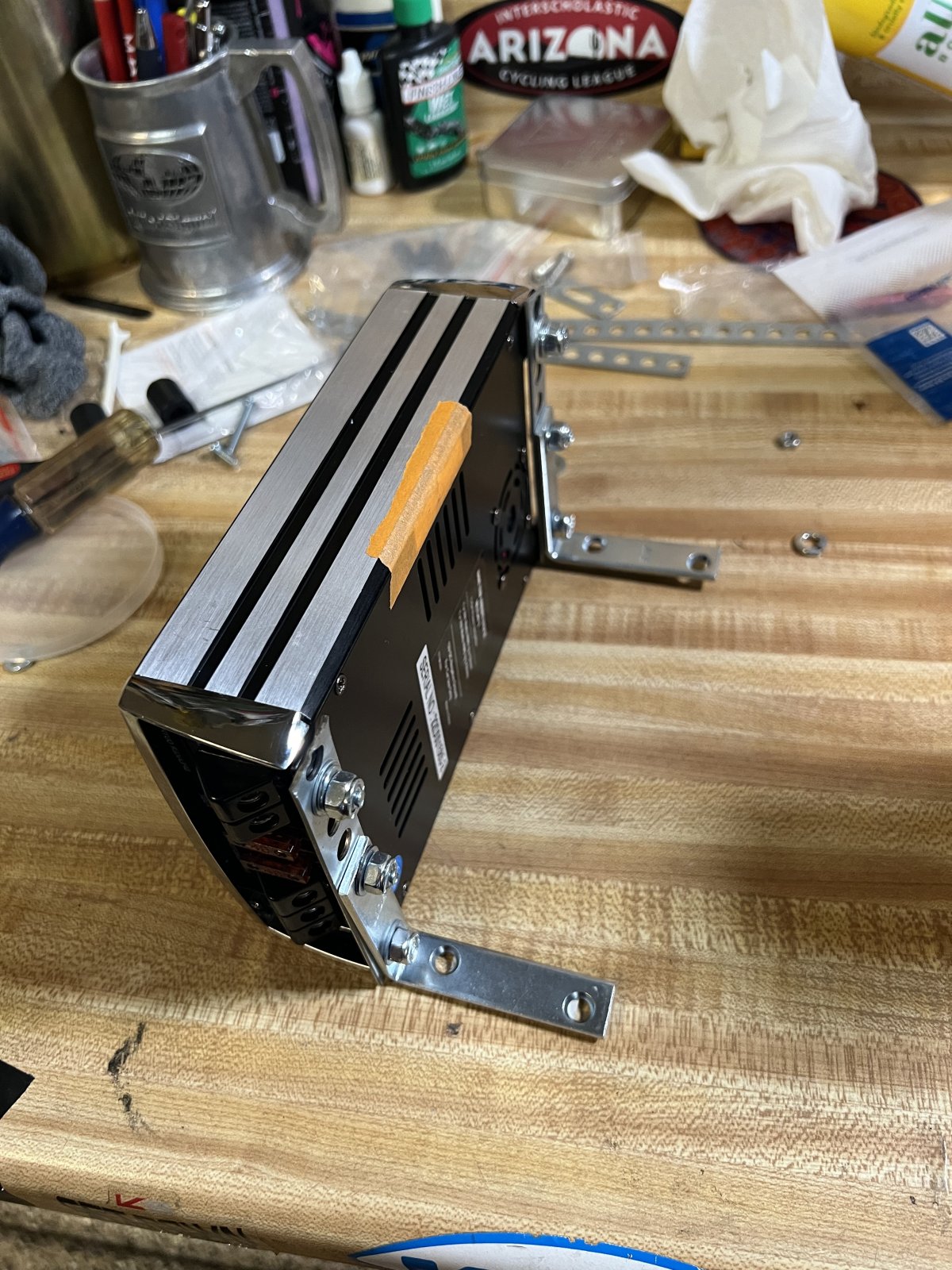

I thought long and hard about that cubby but ended up installing that same amp under the cup holder because was concerned about heat buildup. Are you going to install some type of louvre vent to get some air on there? Since the cooling fan is on the bottom you might want to ride it up just a little on spacers. Good clean setup. Overall though. Nice work on the sub. Here’s my amp and sub IMG_1635.jpeginstall.

I'm still engineering in my mind what I want to do. It isn't secured right now and while the frame provides the 1/4" air gap the manual states is required, it doesn't do two things: allow enough airflow (IMO) nor make it easy for me to tweak the settings since it requires a tiny flathead.
My buddy has some fancy (read expensive) 3D printers that I'd like to come up with a solution and try printing. However, I'm not able to explain enough over text message for him to understand the goal. I will look around on thingiverse and maybe download a CAD program or something.
My Bose Lux amp and subwoofer are in the center console where you have yours, so that wasn't an option. Sure would have made for shorter power run!
