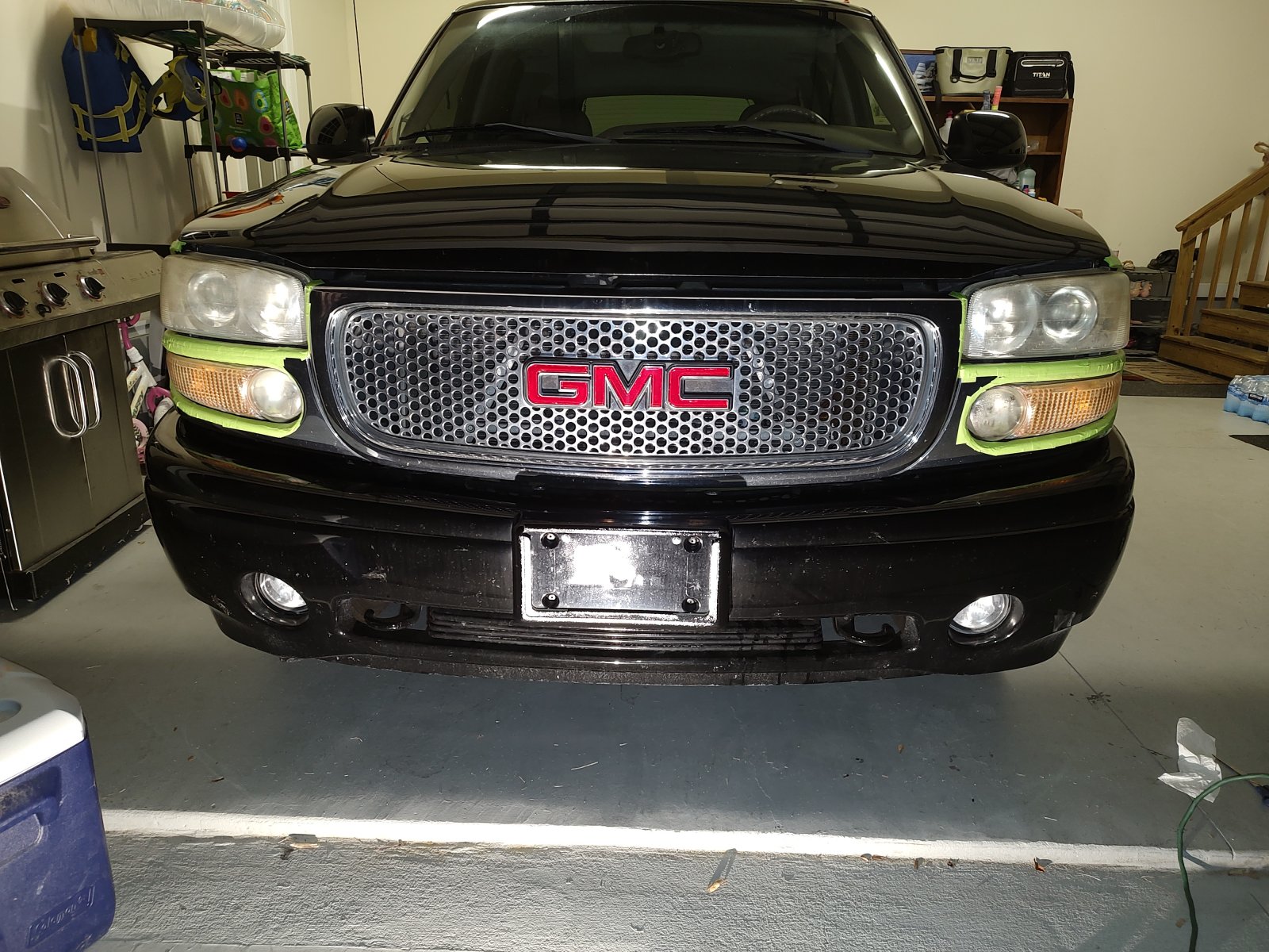

Refreshed the headlights and turns signals. They weren't terrible to begin with but they looks so much better now. It really makes a difference in how old the truck looks when they are cleaned up.

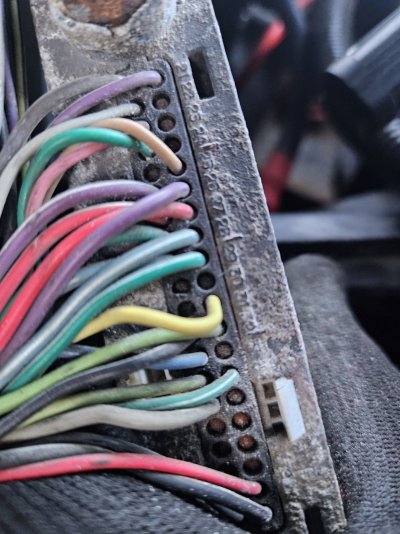

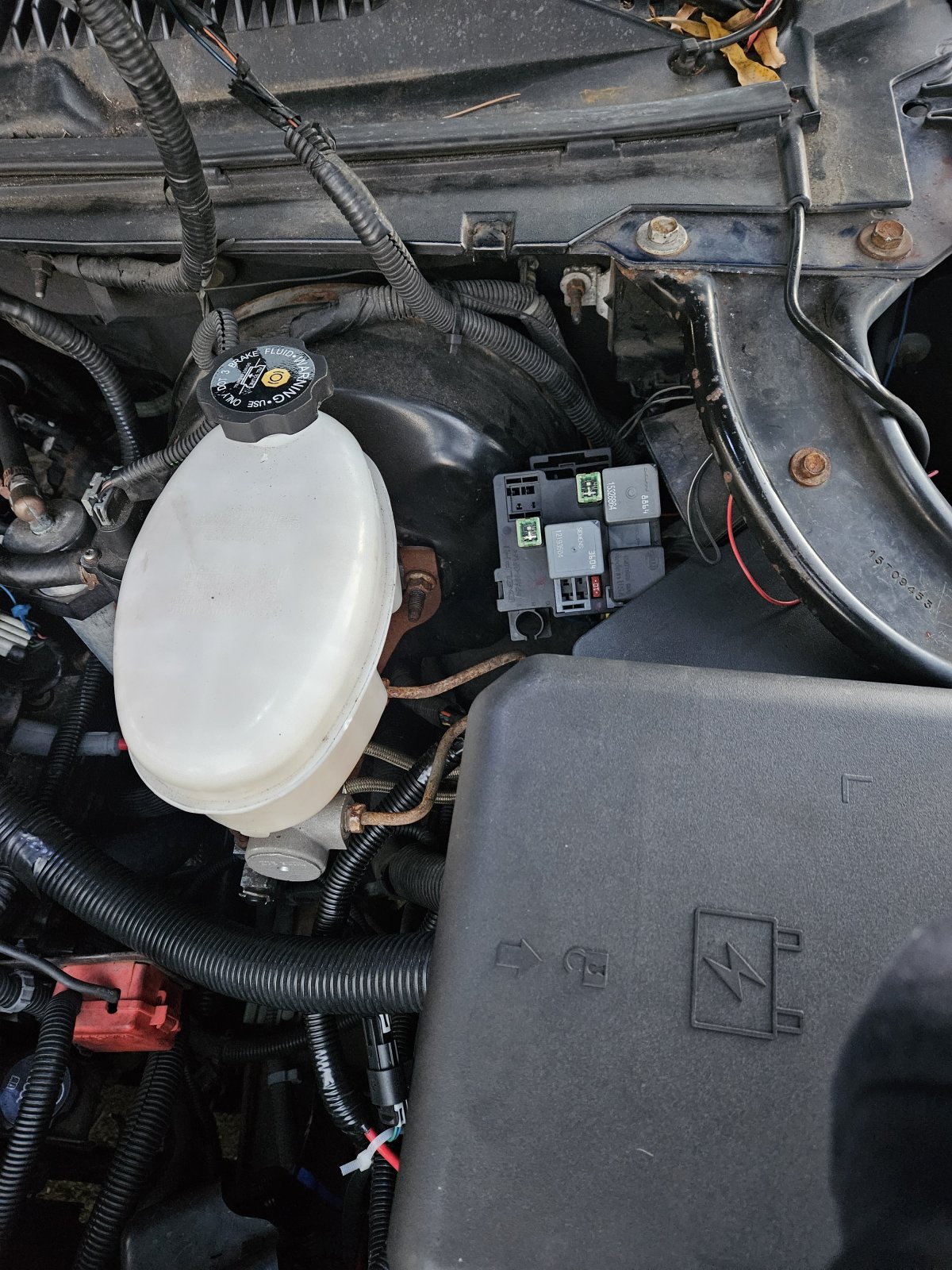

Ok, I finally installed my electric fans. Followed instructions to the letter. The fans aren't kicking on. It actually overheated while running. Stuck the correct wiring/color into the corrects pins, into the pcm. Everything else was pretty much self explanatory. Should any of the plugs going to the fan be hot at anytime? I even tested the plug that the 2 fan leads terminate to. I bolted the constant 12v to a hot pole in the fuse box, and I have a good ground--I tested it to make sure. What am I missing here? @ScottyBoy ? Anyone?? 20231118_154605.jpg20231118_163838.jpg20231118_163846.jpg

Ok, I finally installed my electric fans. Followed instructions to the letter. The fans aren't kicking on. It actually overheated while running. Stuck the correct wiring/color into the corrects pins, into the pcm. Everything else was pretty much self explanatory. Should any of the plugs going to the fan be hot at anytime? I even tested the plug that the 2 fan leads terminate to. I bolted the constant 12v to a hot pole in the fuse box, and I have a good ground--I tested it to make sure. What am I missing here? @ScottyBoy ? Anyone?? View attachment 414533View attachment 414534View attachment 414535
Did you get the pcm program for the fans to kick on?

FIXED!!
It was instructional error. I had the constant 12v bolted on a constant hot pole under the plastic fuse panel. I moved it to the constant 12v "red box" next to the alternator. Fans work as they should.
Thanks to everyone who chimed in.
Constant hot is constant hot. It should've worked. Unless, that constant hot wasn't actually a constant hot, like if it was for a trailer brake or the power for an RV plug. Which, I think it'd need the fuse installed to actually make it hot. I think my fuse & relay center has two terminals next to each other- one is always hot, like the main power coming in and the one next to it is the auxiliary.
