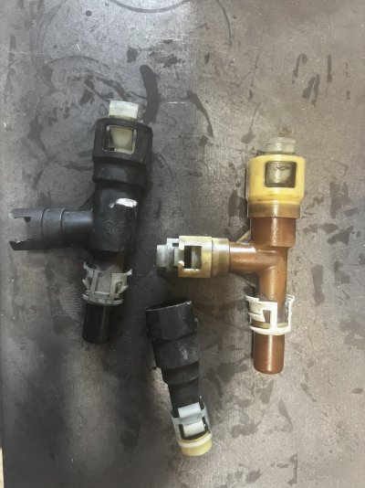

dps01
Nov 25, 2017
146
359
N. TEXAS
Shiny new parts…
Showed the 03 Z71 some love today and gave myself some piece of mind changing these out before failure….
Hopefully the replacement AC Delco parts go another 240K like the originals did.

dps01
Nov 25, 2017
146
359
N. TEXAS
Shiny new parts…
FWIW (..maybe nothing)…
Decided to do an admittedly non-scientific destructive test with a vice prior to discarding the tees.
The white tee more or less crushed with little deformation. The black tee snapped (as you would expect a rigid plastic fitting to do) vs crush. It also took .25 to .50 more turn on the vice to break the white one.
Looking @ the pieces, it looks like the white (supply line IIRC) one would have failed 1st.
