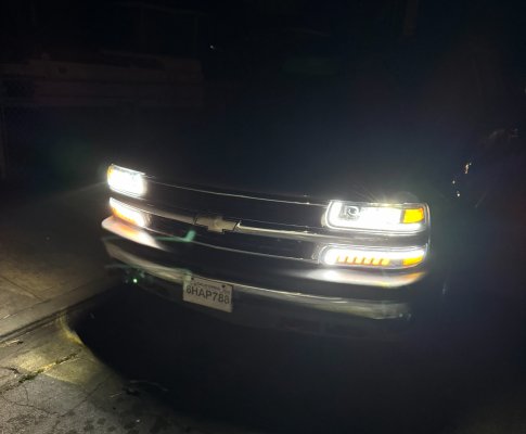

Not quite sure how to have just the DRLS on at night. But this gives sort of a thought as to how bright they are.
Just wire them up to a switch if you want JUST the DRL's on. If you just want to temporarily turn them on just to see how they look, you can pull the DRL relay, and put in a jumper wire from terminal 30 to terminal 87 in order to force them on.

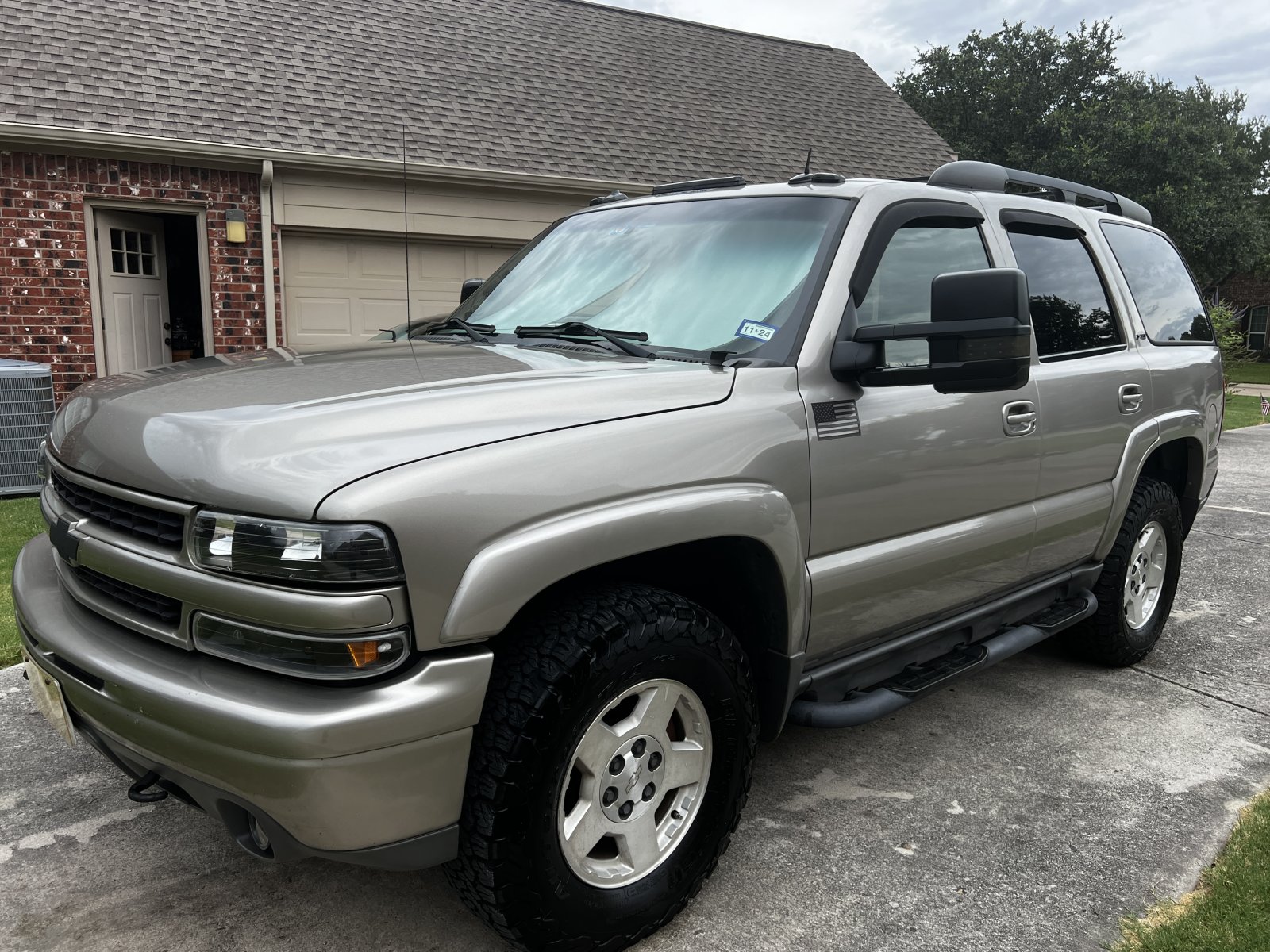

Felt like the front end was falling out of my '04 Yukon for the last year. Replaced wore our Ranchos with Bilstein 5100s. Also added a quart of MMO to the oil a few weeks ago. Lifter tick is is gone now after listening to it for the 5 years I've owned it.
